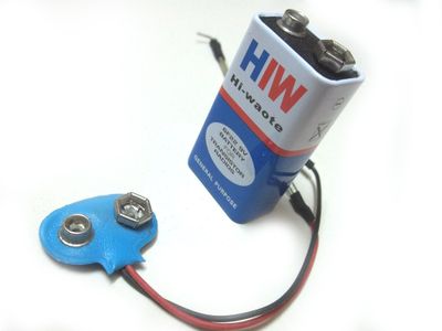

Step 3: Power Supply Circuit
The Arduino Uno used in this project is powered by a 9v battery. The Arduino has an on board regulator which can receive an input voltage within the range of 6v - 20v. Due to this, we do not need any additional circuit to regulate the input voltage to the Arduino when connected to a 9v battery.
1. Solder the bent Male Header Pins to the two wires of the 9v battery snap.
2. Cover the soldered points on the wire with insulation tape or heat shrink. The header pins soldered to the battery snap must look like pic. 2.
You are now done with the power supply circuit for the Arduino.

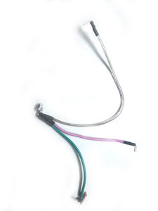

Step 7: IR LED Stem
The decoded IR pulses stored in the Arduino is transmitted back to the TV using the IR LED.
1. Solder two long electrical wires of equal length to the leads of the IR LED (Refer to pic. 2).
2. Cut a length of the steel wire slightly longer than the electrical wire.
3. Firmly wrap the steel wire to the two electrical wires. This creates a flexible stem for the IR LED which can be directly positioned in front if the IR Receiver of the TV (Refer to pic. 1 and pic. 3).
4. Cut a small piece of the PCB and solder a Male Header Pin and the 100 ohms resistor to it. The resistor will connect to the positive lead of the IR LED while the Header Pin will connect to Arduino Pin 3 (Refer to pic. 4).

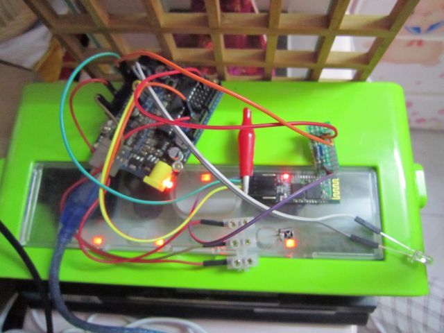

8 years ago on Introduction
this code can not use, help me!
Aergia is ready!
Bluetooth Module is ready to receive commands
settings
Configuration mode entered
Button configuration started.....
FFE01F
16769055
Decoded NEC: FFE01F (32 bits)
Raw (68): 6784 9200 -4200 850 -300 800 -300 800 -350 800 -300 800 -350 750 -350 800 -300 800 -350 750 -1450 750 -1500 750 -1500 750 -1500 650 -1600 650 -1600 600 -1600 650 -1600 650 -1600 600 -1650 600 -1600 650 -500 550 -550 600 -550 550 -550 550 -600 550 -550 550 -550 600 -550 550 -1700 550 -1650 600 -1650 550 -1700 550 -1700 550
Button configured......
Sending Button Info...
Exiting loop and entering normal mode
e
Command received from Phone:
e
E
0
0
...i USE the Arduino-IRremote-master example IRrecord.ino...the IR LED had output but i used Bluetooth_Remote_Program.ino...the IR LED no output
can you help me ?
