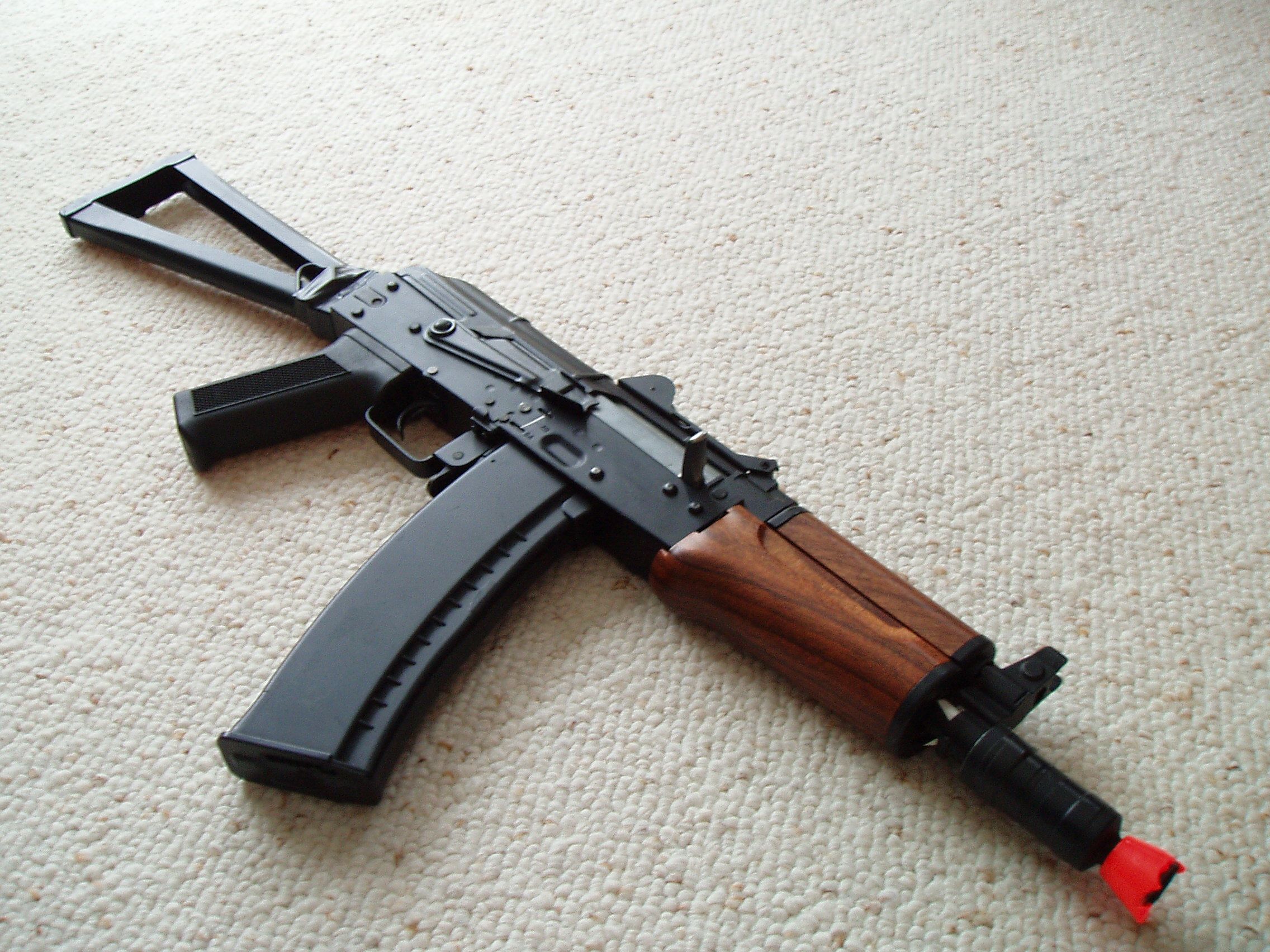

Step 1: Intro to AEGs
electric airsoft guns can be put into into two catagories:
Tokyo Marui (TM) Based; MPEG (mid priced electrig gun) and AEG (automatic electric gun)
Non-tokyo Marui based; systema PTW, LPEG (low price, or low power, electric gun)
LPEGs have plastic internals, and often, funky gear systems, and Systema PTW is something I am simply not qualified to talk about so I will cover only TM based electrics.
TM based guns are the ones based on, and usually compatible with, the original TM version of said gun.
MPEG v AEG
AEG, depending on who you ask, either means any TM based electric, or any gun made by the higher end electric gun manufacturers such as TM, Classic army, KWA, or G&G.
MPEG is generally generally defined as lower priced (100-ish dollar range) versions of the higher priced guns. They are often not that much worse in performance, however, only durability. Some companies that make MPEGS are CYMA, JG, Echo 1, SRC, D-Boys, and UTG. I can personally vouch for CYMA and JG.
