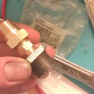

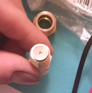

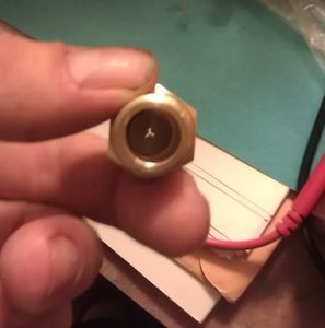

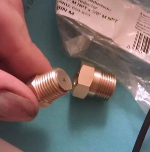

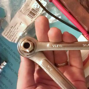

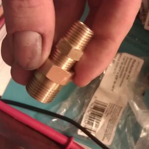

Step 2: Fit Nozzle
Pipe diameters are nominal only -- that is, like a 2x4, a 3/8" pipe does not have an inner diameter of 3/8" -- it is nearly 1/2" and varies with the wall thickness of the pipe.

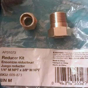

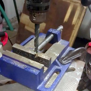

I drilled out the 1/4" side of a 1/4" to 3/8" adaptor. It is a brass peice made for pressure washers (ie it is in the pressure washer section of home depot). My plan was to insert the kinetic nozzle in the 3/8" end, but the ID was too big.
The 1/4" side is nearly 3/8" -- being brass it is easy to drill, I used a 3/8" bit and drilled to about half the depth of the connector.
The fit was very tight. I put the stainless steel nozell in the freezer and the brass peice in boiling water. This did not really make differnce. I ended up scrapping the inner wall with the drill bit. I was then able to tap the nozzle inplace without too much force.
Then screw together the 1/4 and 3/8" sides of the brass reducer. The whole thing is pretty tight.
Light is only visible through the fancy hole in the nozzle.
Then I connected the 1/4" to 1/2" adapter to the 1/4" end of the brass one. This has a female 1/2" NPT thread so it will work fit a 1/2" male pipe coming out of the pump.

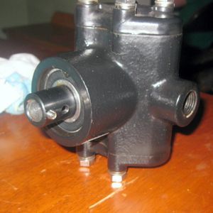

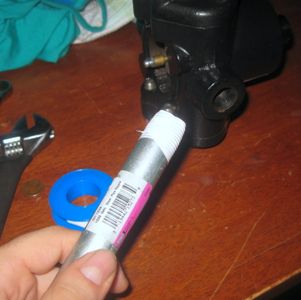

Step 3: Add Pipes to Pump

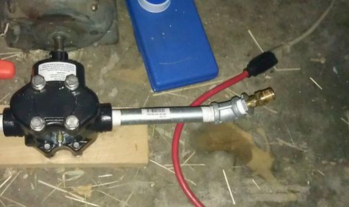

The pump inlet and outlet have 1/2" female NPT threads. So you can use 1/2" male pipes. Use teflon tape on the threads, then you can get a good seal and you will still be able to take it apart.
One pipe goes in each side.
The nozzle assembly goes on the outlet side.
I also used some angled fittings, but for this build they are not needed.

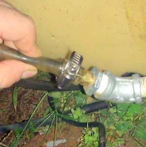

Step 4: Add Tubing
Solid pipes or very heavy tubes would be best. I didn't want to spend alot of time doing plumbing (I also didn't have anymore pipes).
So -
on the inlet side
- Put a 3/4" tube over the pipe
- Add a pipe clamp
- Stick a piece of garden hose in the other end of the 3/4" tube - maybe a 4ft hose, I didn't measure but used enogh to get to a bucket
- Add a pipe clamp
On the outlet side
I used a piece of tubing off of a pool cover pump (little giant) -- the tube was a little too small to fit over the 1/4" brass fitting. I heated it up with a cigiret lighter and was then able sort of screw it on. Add a pipe clamp. This is not what I'd planned to do, but it seemed to work fine. The nozzle is secured tightly so it should not pop out at 300psi.

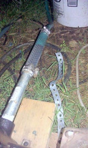

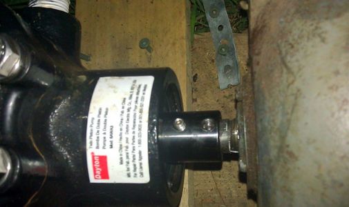

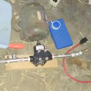

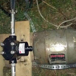

Step 5: Connect Motor to Pump

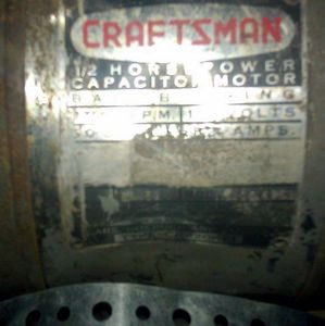

The best would be if the motor had a 5/8" solid shaft with a keyway (as the pump has a hollow 5/8" shaft with keyway)
I only had a motor with a 1/2" shaft. I wrapped some steel sheet metal (22 gauge) around the shaft and tightened it as much as possible with pliers. This works, but I was not able to get the alignment correct, this makes pump vibrate a little too much.
I mounted the motor to a piece of wood with screws/washers (not great).
The pump is basically loose. I tried strapping it down, but this looked like it was going to destroy itself pretty quickly. The pump came with a leverage bar. It attaches to the bottom of the pump with the same bolts that hold the pump together. I think you are supposed to have the rubber part on the outlet side of the pump. I set it up opposite, so just a metal bar is pressed against the wood, this started squeaking loudly when the pump was running. I added some thick grease to silence it.

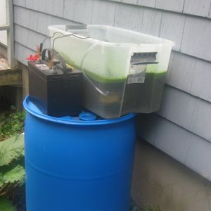

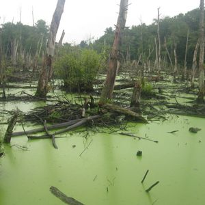

Step 6: Get Algae

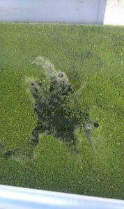

I went to a swamp and scooped out a bunch of stuff with a net. I think I mainly got duckweed. I then put the algae and swamp watter in a clear bin.
I put the baitwell pump in the algae water and ran it for about 4 hours.
I don't know if this made any difference.
It is a 12Volt pump, so I used a 12V marine/car battery.
The pump is connected to to a venturi thing that sucks air (through a little hose) and mixes it very well with the water. Almost like the water is carbonated (I guess that is actually what is happening). I ordered this from Dan, the let-em-live guy. It looks like nearly the same thing is used in hot tubs to add the bubbles, so you could probably use one of those (although I did like talking to Dan).

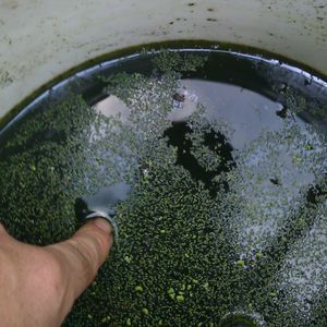

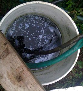

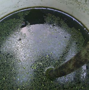

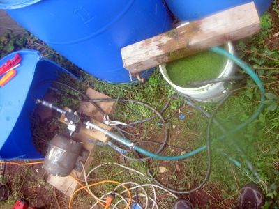

Step 7: Make Some Oil (I Think)
I was just trying to produce some sort of oil evidence. So here is what I did.

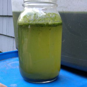

The algea water went into the pump pretty clear with floating duckweed. It came out of the pump a thick green color. I assume that it is mainly crushing the duckweed.
I couldn't really tell if anything had happened. But I was happy enough to have something running. I left the bucket out overnight uncovered. The next day there was an iridescent film over the top. I think this is the first sign a conversion too fuel. The film is sort of like a thin layer of plastic, or wax. I know that diesel fuel doesn't evaporate fast, like gasoline, but I don't know what it does if left exposed to air.
I skimmed of the film and put it in a jar, I don't really have a plan, but I am waiting to see how it settles.
- Dump the algae/water in a 5 gallon bucket
- Put the in and out hoses in the bucket
- Ran the pump for about 2 hours ( this was pretty arbitrary, I don't have a sense of how long the process takes)

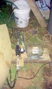

Step 8: Overview of the Set Up
Here is the overall setup -- it is crude (pun!), but functional.

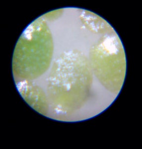

Step 10: A Little More
I don't know how to gauge the ratio of algae to water. The macroalgea is easy enough to see, but the micro stuff is, well, microscopic.
I got a very cheap microscope and was able to capture some images by pressing a camera to the eye piece. I think I need to get up to 400X magnification to see the little guys.
