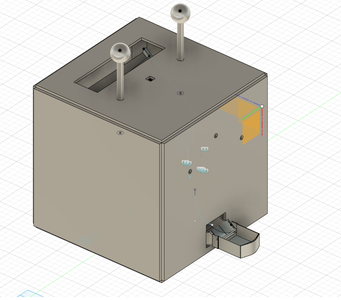

Step 1: Build the Main Body Part 1
  1. Cut 4 Pieces of MDF wood into a 2’x2’ square
  2. Cut 2 Pieces of the plywood into a 2’x2’ square
  3. Cut the 2x4s into 4 2ft pieces (these will be the frame of the box.
  4. Cut a piece of 2x4 into 10.5’’
  5. Using the wood screws and a drill, attach the 4 2x4s onto the edges of one of the pieces of plywood all in the same orientation (as shown)
  6. Cut out the face of the alien according following to figure A
  7. Drill a hole at the edges of the the “mouth”
  8. Using a Jigsaw, cut out the hole for the mouth of the alien.
  9. Drill circular holes for where the eyes will be on the face. The left hole is 7 Inches from the left wall and 9 inches from the top of the box. The middle hole is 12 inches from the left wall 5 inches from the top. The right hole is 7 inches from the right wall and 9 inches from the top. Each hole is .75 inch in diameter.
  10. Secure the face of the alien to the frame of the box using 3 screws on each side, one on the top, another in the middle, and the third at the bottom, Line up the board so the top of the board lines up with the top of the 2x4, the board should be attached to the thin side of the 2x4s as show

Step 4: Candy Dispenser
  1. Insert the axle into the Spinner, it will be a tight fit so feel free to use something to push it in.
  2. Place the Axle and Spinner into the Candy Dispenser body, then close the cap over it as shown.
  3. Using Hot glue, connect the candy output tube to the 9’’ piece of 2x4, line up the bent part of the tube so that It would be 1 inch from the bottom of the 2x4 as shown
  4. Put the Candy Dispenser into the existing body, lining up the tube with the mouth of the alien, line up the bottom lip of the tube with the bottom lip of the alien
  5. Using Hot glue, connect the mouth of the alien to the Bottom tube, outside of the alien as shown.
  6. Place the Candy Dispenser on top of the Bottom tube as shown
Step 5: Build the Main Body Part 2
  1. On top of the 9” piece of the 2x4, attach a 5” x 8” wood board with wood screws as shown. This will be the board to place the electronics.
  2. Place the circuit on this board and fit the motor into the hole in the candy dispenser as shown. Secure the motor with hot glue. Use the adhesive of the breadboard to attach it securely on the wood board. Hot glue on the bottom side of the UNO board, H-bridge, and battery pack to secure it.
  3. Attach the corresponding IR sensors and LEDs to each hole for the alien eyes. Make sure the holes are big enough so the entirety of the IR sensor and LED can fit through. Widen the hole if necessary. Secure it with duct tape as shown.
  4. Create the funnel from the 3D printed parts by glueing them together.
  5. Position the funnel so that the output end of the funnel lines up with the input tube of the candy dispenser as shown. Tilt the funnel so capsules will roll down.
  6. To hold the funnel in this position, cut two 2x4s into 2ft pieces. Cut the top of each piece at an angle so the funnel can rest at the position defined in section l as shown.
  7. Use wood glue to attach the funnel onto the 2x4 pieces. To attach the wood pieces to the body, screw in wood screws from the bottom of the body.
