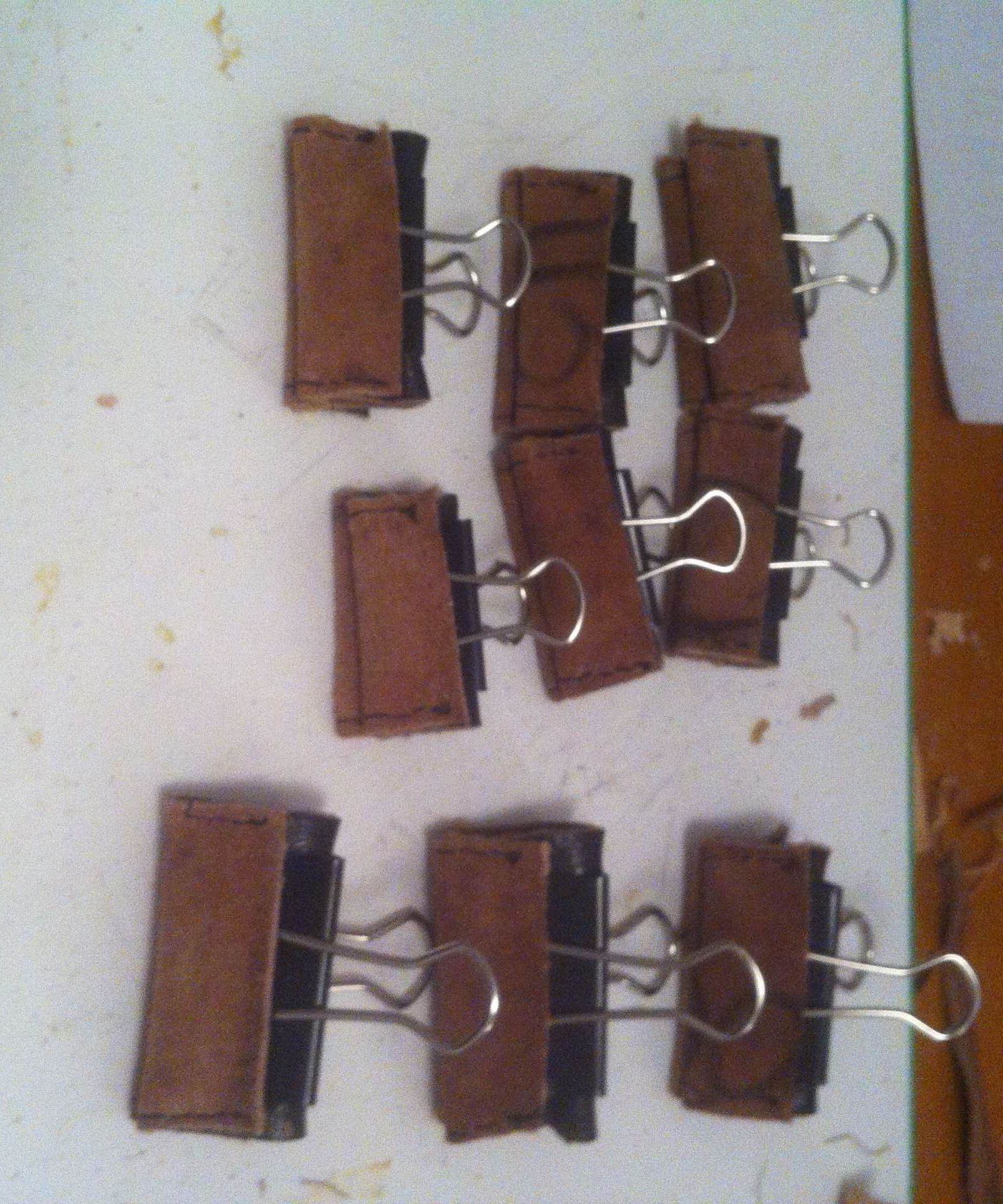

I suggest first putting some contact cement in the borders to join, as instructed by the manufacturer, then press strongly, making sure that the alignment is right.
Then, poke some holes and stitch. (I Used a traditional saddle stitch but you can use whatever you prefer)
