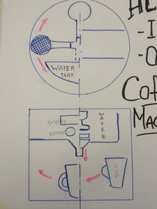

Step 2: Сoncept

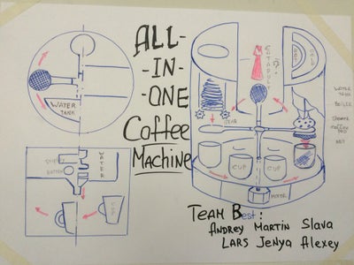

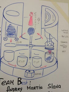

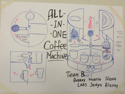

Our coffee machine consists of several parts:
  • carousel cups of coffee with the definition of the presence of the cup;
  • unit for coffee brewing;
  • transporter coffee pads;
  • coffee pads' separator.

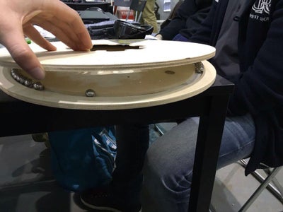

Step 3: Сircus Has Arrived

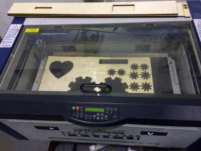

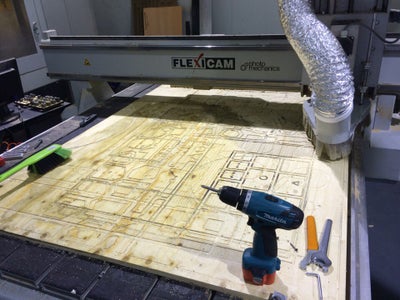

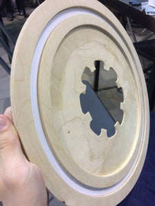

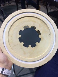

We cut out a platform for cups with a laser machine. Connected it to the motor. For the best sliding we used steel balls.

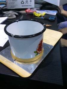

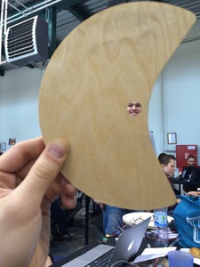

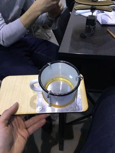

We took a water boiler, pump and tank with an old coffee machines. From steel mug and wood we made a hermetic chamber for brewing coffee. From aluminum sheet we cut plate with holes for pouring.
Step 5: You Spin Me Round

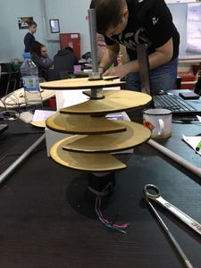

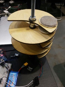

It's simple: you put coffee pads on the platform, and it gives you one by one while rotating them. Profit! Rotation is realized by stepping motor and the threaded rod.

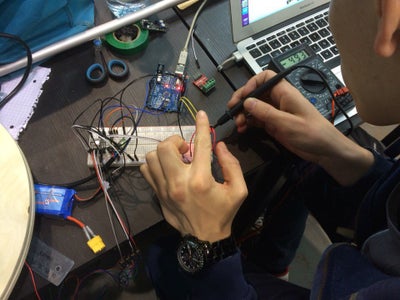

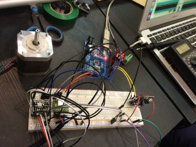

Step 6: Electronics

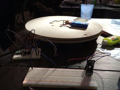

We have Martin and Martin have Arduino. He connected sensors and motors to the Arduino to our project gained the mind and movement.

To make our dreams come true, we did our project in Fab Lab Polytech, where there is everything necessary for the implementation of engineering ideas: laser, milling machines and 3D-printers.
