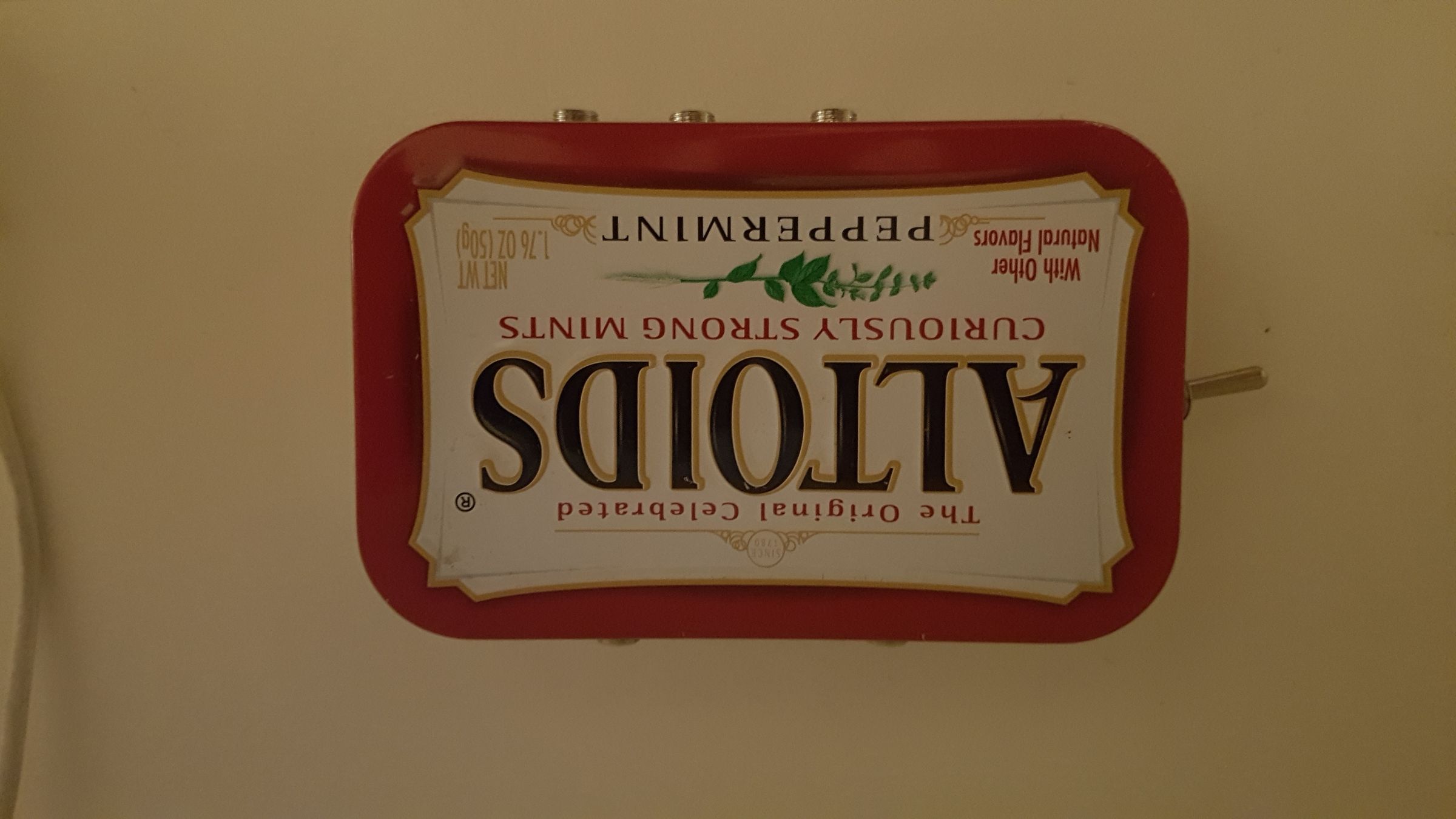

Introduction: Altoids Tin 1/8" Stereo Mixer
About: I have a Masters degree in Electrical Engineering from Carnegie Mellon and have been working in the field of Automation, Robotics and Embedded Systems for over 20 years. I've always enjoyed tinkering/inventing…
My car stereo has only one 'Aux' input, but I have several gadgets that I like to hear on a trip without swapping cables: MP3 Player, talking GPS, Blackberry, XM player, Kindle, etc.
I couldn't find a commercial solution, so I came up with this little passive audio mixer that takes 1/8" headphone outputs from up to four devices and safely mixes the signals into one line that can feed a car stereo Aux input, powered speaker or any other amplifier that can take 1/8" stereo output.
No batteries are required, it's sonically transparent and most audio gadgets have their own volume control so the mixer can be done very simply and cheaply.
This little mixer also works great for connecting multiple computers to one set of amplified speakers and has many other possible uses. Note that this device is NOT RECOMMENDED FOR HEADPHONES!!!! Whatever you plug into the output needs to have its own amplification, or the volume will probably be too low.

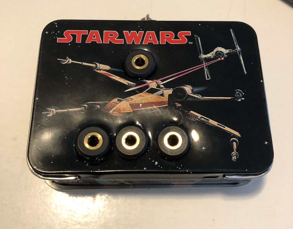

Step 3: Mark Center-line for 1/8" Jacks
Scribe a line on the tin 1/4" from the bottom edge on these two sides:
   - the long side opposite the hinge side (input jacks)
   - one of the short sides (output jack)
These will be the center-lines for drilling the holes for the jacks.
Step 4: Mark & Pre-punch Holes for Jacks Before Drilling
Mark and pre-punch the positions for drilling the holes on the center-line with an awl or fine marker. Position is not super critical, but should be even if you want your project to look neat.
- Make 4 marks on the long side center line, spaced out by about 3/4 of an inch.
- Make 1 mark on the middle of the center-line on the short side.
- In order to keep the drill from wandering, it's good practice to punch the holes with an automatic punch or awl.
Hint: It's a good idea to put a small piece of wood or a big rubber eraser behind the thin metal to keep it from bending.
Step 5: Drill 1/4" Holes and Clean Ragged Edges
Drill each hole with a 1/4 drill bit. Again, a small piece of wood behind the metal will keep it from bending and make the backside of the holes neater.
Carefully clean up the ragged edges of the holes with the side cutters or a sharp knife like an exacto hobby knife. This is important so the jacks sit flush.
Hint: As always, safety first, follow this rule: never put anything in front of a sharp blade that you don't want to cut!

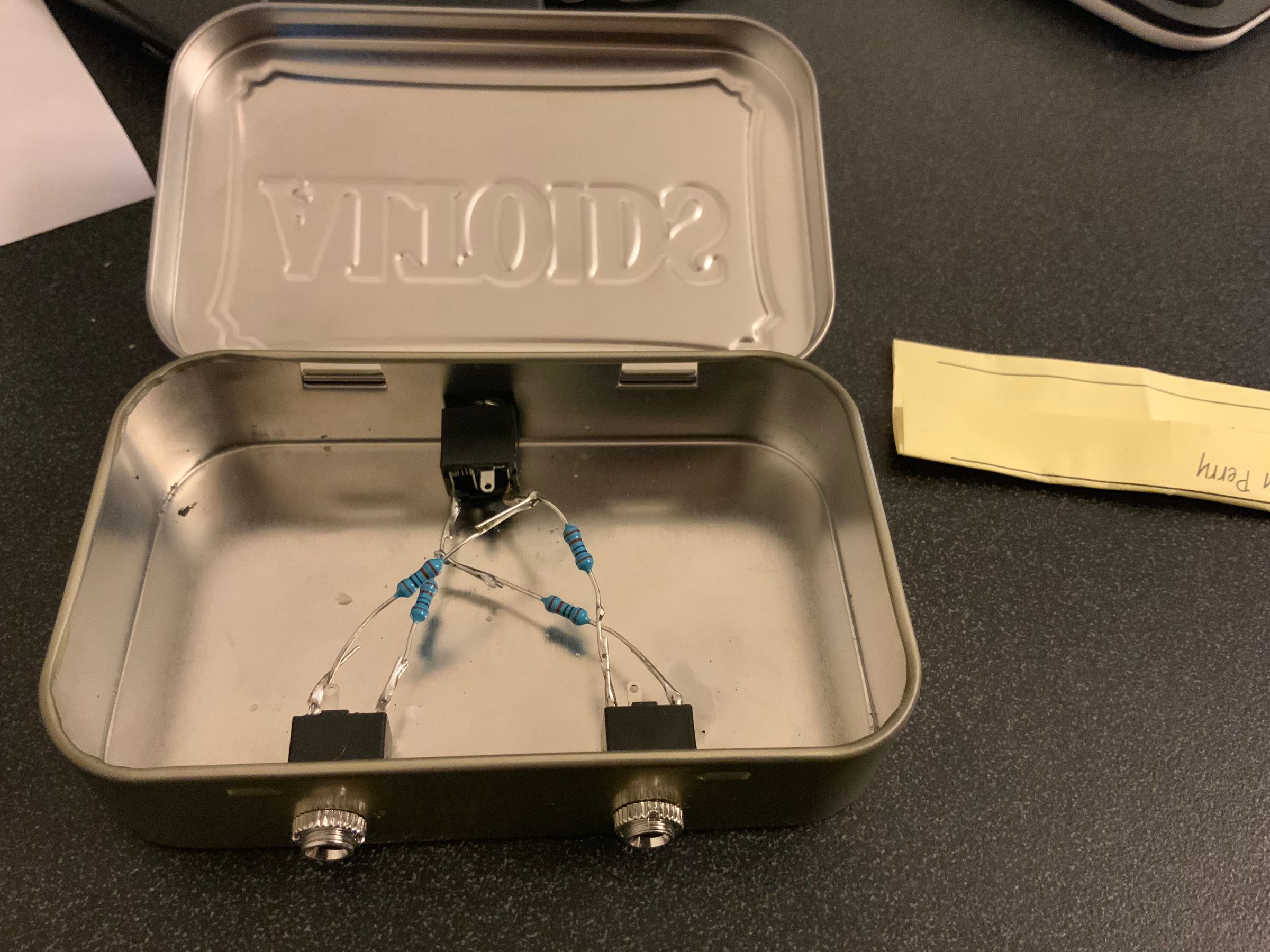

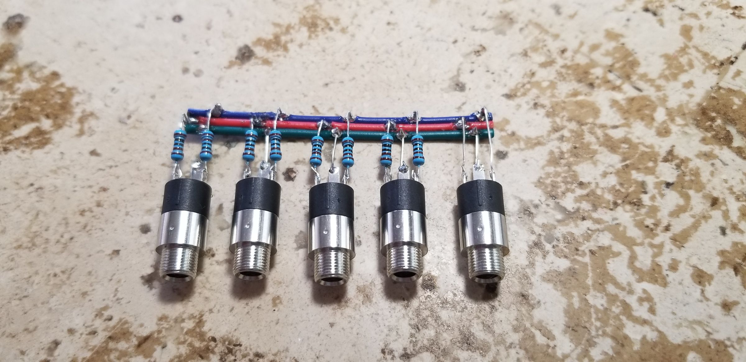

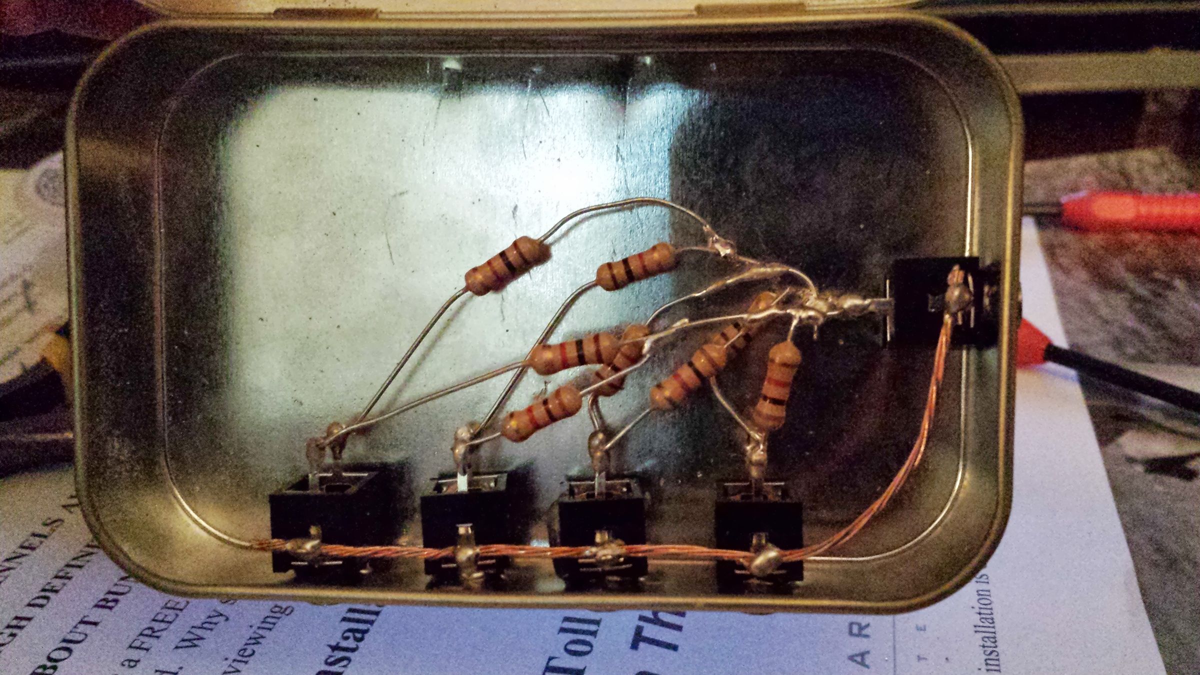

Step 9: Attach First Resistor to Middle Tab (Right Channel)
1) Take a resistor and attach to the middle tabs of the output jack (the one by itself) and the closest input jack (see picture).
    - Make sure the resistor body is closest to the first input jack.
    - solder in place
NOTE: it is very important that there are no shorts with the ground wire, case or other tabs from this point on.
Step 10: Attach Remaining Resistors to Middle Tab (Right Channel)
1) attach a resistor to the middle tab of the next input jack
   - solder & trim excess wire
2) wrap the other lead of the resistor around the lead of the resistor in the previous stage (see photo),
   - make sure that this end has a direct electrical connection to the middle tab of the output jack.
   - solder and trim excess wire.
3) Repeat until all input jacks have their middle tab tied to the output middle tab through a  resistor
4) After attaching all resistors to middle tabs (right channel), gently bend the entire string down slightly to make room for the left channel resistors.
Hint: Do the connecting, soldering and trimming of each resistor one stage at a time, this will be a lot easier than fitting and soldering all inputs at once.

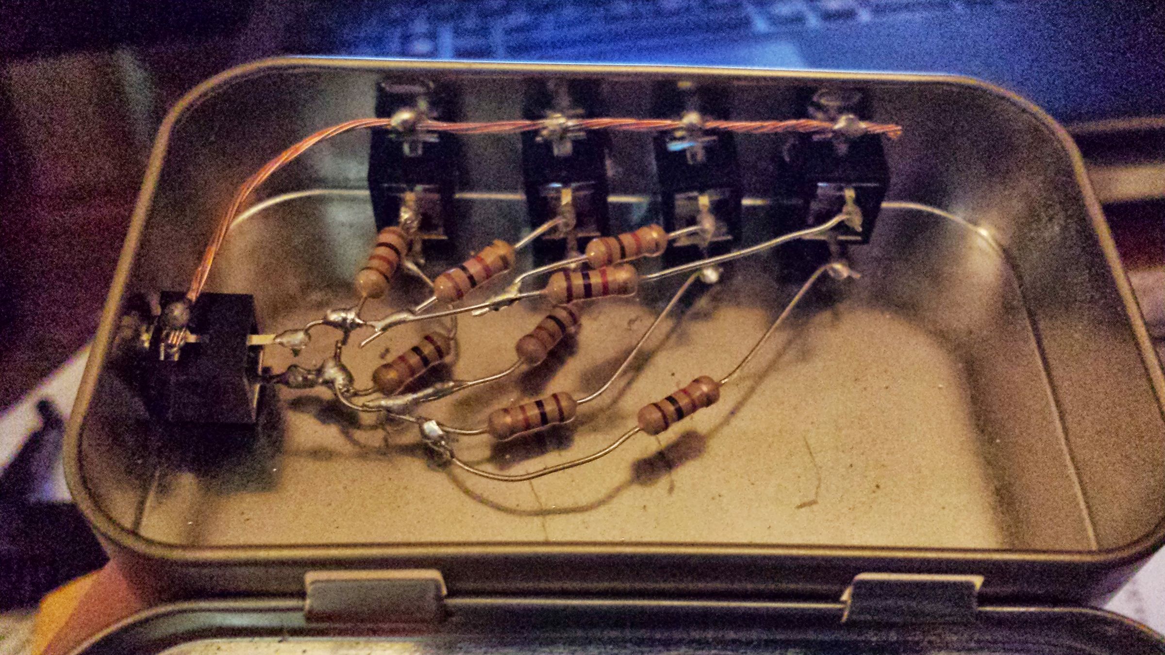

Step 11: Attach First Resistor to Outer Tab (Left Channel)
1) Take a resistor and attach to the outer/left-challe tabs of the output jack (the one by itself) and the closest input jack (see picture).
    - solder in place
Step 12: Attach Remaining Resistors to Outer Tabs (Left Channel)
1) attach a resistor to the outer tab of the next input jack
   - make sure that this end has a direct electrical connection to the outer tab of the output jack.
3) Repeat until all input jacks have their outer tab tied to the output outer tab through a resistor
4) After attaching all resistors to outer tabs (left channel), make sure there are no shorts/connections between left channel and any other wires.

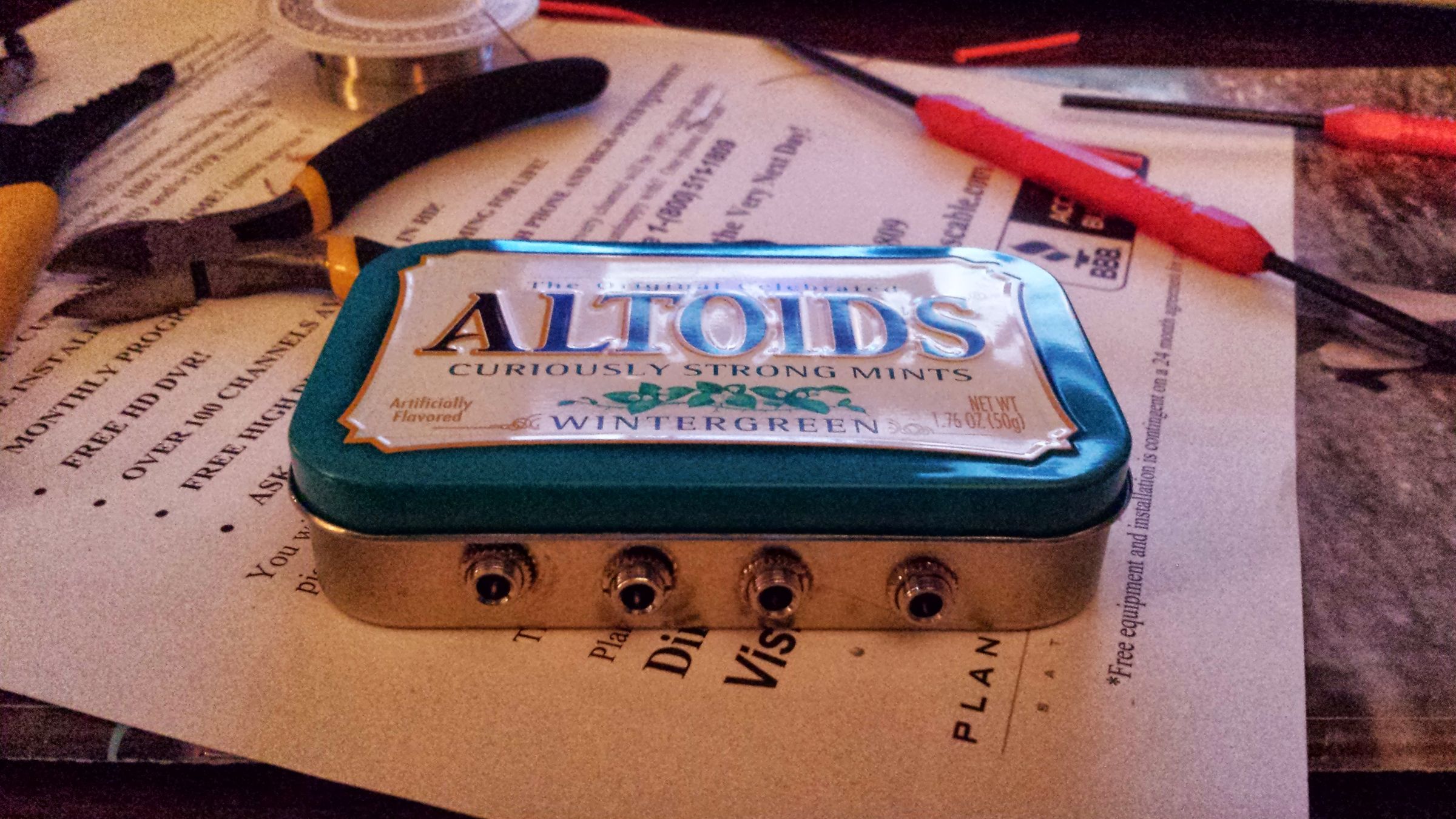

Step 13: Done! Testing and Troubleshooting.
Congratulations, you should now be done. Close up the Altoids tin and test the mixer:
- attach the output jack to a known good powered speaker
- attach an working mp3 player to each input in turn.
Problems?
If something doesn't seem to be working check these things:
1) Do you get sound with mp3 player, cable(s) and powered speaker without the mixer?
2) Double check wiring. Is everything wired correctly, per instructions?
3) Any cold solder joints? (solder joints that look good but don't really connect) Try resoldering any suspect connections.
4) Any shorts? Shorts are accidental connections caused by wires touching each other. Look carefully and pull apart wires that look like they might be touching.

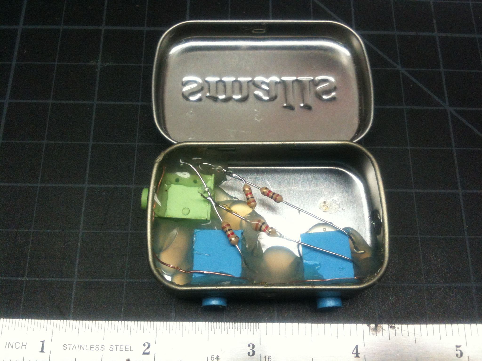

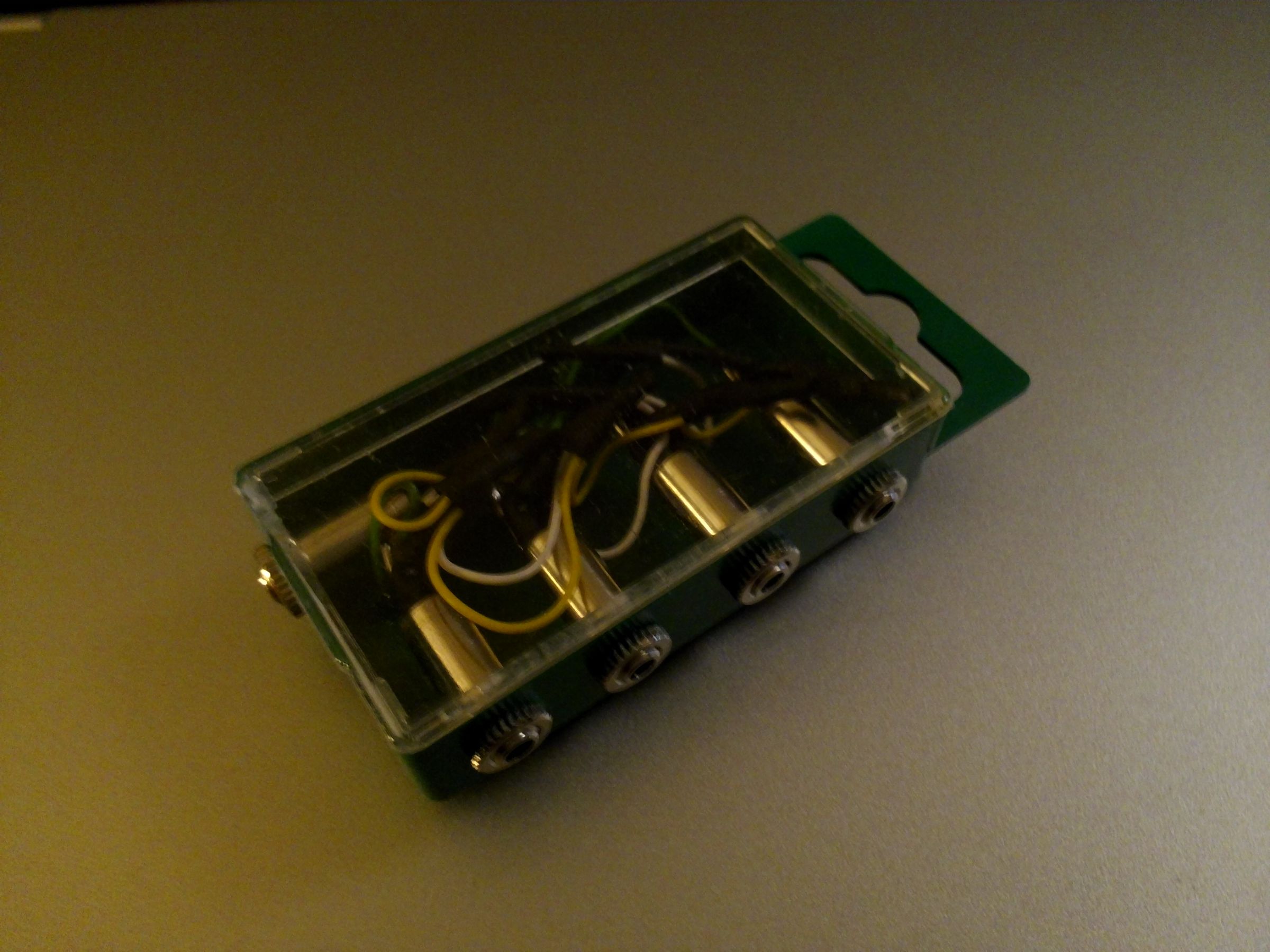

Step 14: Final Comments
It may look strange to build an electronics project without a circuit board in this open wiring style. Old timers called it "rats nest" wiring, but despite the negative term it's perfectly OK.
If you construct it right, the wiring has enough strength to stand on its own and the box provides adequate shielding.I've used my mixers in the car and elsewhere with no problems for several years.
However, if you're worried about the open wiring, then you can always cover the bare wires & resistors with electricians tape, just make sure not to break something in the process.
If you really wanted to make the mixer super rugged, you could fill the tin with epoxy, parafin or circuit-grade Silicone RTV.
Note: Don't use the regular Silicone RTV made for caulking and bathroom sealer. This stuff gives off acetic acid which will eat through your wires and ruin your project after a while. Circuit-grade Silicone RTV does not give off acid and is safe for wiring. I've read that GE Silicone II (available at home improvement stores) does not leach acid and also silicone RTV sold at automotive part stores labeled either 'Oxygen-sensor Safe' or 'Type B' should be OK.

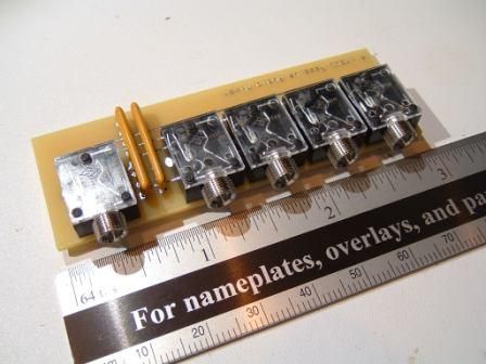

Wow, really nice job! Good idea to use resistor networks!
Would you care to share the artwork?

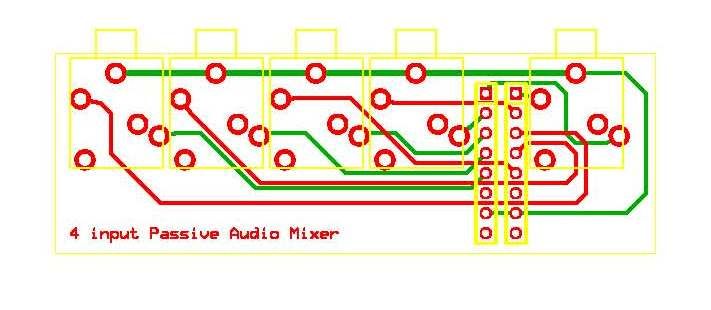

0
chipmonger
chipmonger
Reply 11 years ago on Introduction
Jacks are Mouser 161-3508-E. Resistor networks are Mouser 652-4608X-1LF-1K 1k ohm. Other resistor values are available. Board was fabricated by ExpressPCB.com.
0
jkotecki
jkotecki
Reply 7 years ago on Introduction
Can this image be used to have a board made or do we need the ExpressPCB file?
0
chipmonger
chipmonger
This is a 2 sided board and I don't know if the image is scaled correctly once you download it. I do have the ExpressPCB file if you want it. Email me at steve"at"PowerSwitchTail"dot"com.
0
Huszko
Huszko
Reply 5 years ago
I noticed the connection to ground on both resistor arrays (last but one pin). The "rats' nest" desing seems to omit that. Could you explain why it matters?
0
richfiddler11
richfiddler11
Reply 5 years ago
The circuit board layout is chipmonger's and while I see what you mean, I don't know why he choose to tie those 2 resistors to ground -- I can't see that it serves any necessary function (also doesn't hurt anything). The resistor network he's using contains 8 resistors with a value of 1k Ohm each, all tied together on one side and connected to pin 1 (output signal in this case). Pins 2-9 are the other side of each resistor, which chipmonger is using as mixer inputs. He could've done 8 inputs, but only did 4, and needed one network for each stereo channel (L + R). So again, no idea why he choose to do that, but maybe he'll reply. Guaranteed it's not necessary though.
0
Huszko
Huszko
Reply 5 years ago
Thanks a lot for the answer, I could not figure out its role either. Current would flow that way (i think) when an input is present, but there's nothing plugged into the output? I guess I'll build it as is and then make some measurments with a multimeter.
0
richfiddler11
richfiddler11
Looks like a 2-sided board with the silkscreen mask drawn in so you would either need the file or just reproduce it on your own. It isn't mine and I don't have it. Maybe chipmonger would nice enough to provide if you asked.
0
costumatx
costumatx
why did you put the resistors , can we do it with out them ?
0
richfiddler11
richfiddler11
Please read FAQ on step 15. You can do anything you like, but unless you want to use this as a signal splitter, leaving out the resistors is a bad idea.
0
syberdiver
syberdiver
7 years ago
works pretty nice! great idea!!!
0
richfiddler11
richfiddler11
Nice job! I like the jacks you used, where did you get them?
Rich
0
syberdiver
syberdiver
Reply 7 years ago
hi from Germany. I found the Jacks at www.conrad.de but I will make an other one with 6,2mm jacks :-)

EET1982
EET1982
8 years ago on Introduction
I made mine. Not as pretty as yours but sure gets the job done! Stuck with the 1k resistors. Thanks for the great 'structable!

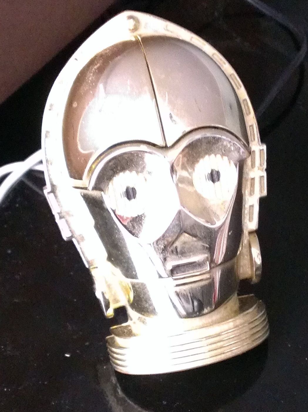

Thanks for posting. Here is my version, it works perfectly.
C3-PO is an old ball mouse. After removing the guts there was plenty of room for the wiring. For the triple input audio jack I used parts from an old motherboard's sound card. They have five leads on each; 1) ground, 2) closed tip, 3) open tip, 4) closed ring, 5) open ring. When a plug is inserted, the part that touches the tip moves from the open tip lead to the closed tip lead. This must be how a computer knows when a plug is inserted. I used the closed tip/ring leads, leaving the open/tip leads alone. I wonder if the the open leads could be used for anything.

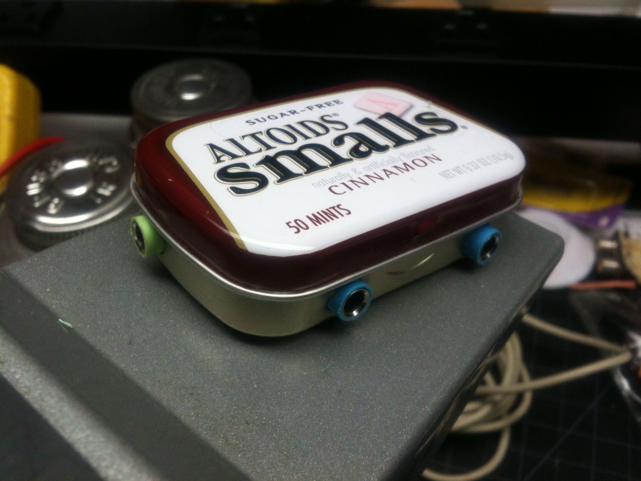

AM Industrial
Thank you. I used pulled parts from trashed sound card and a "Smalls" tin.... I love Old school point-to-point wiring...and Hot glue.

fergusontea
fergusontea
9 years ago on Introduction

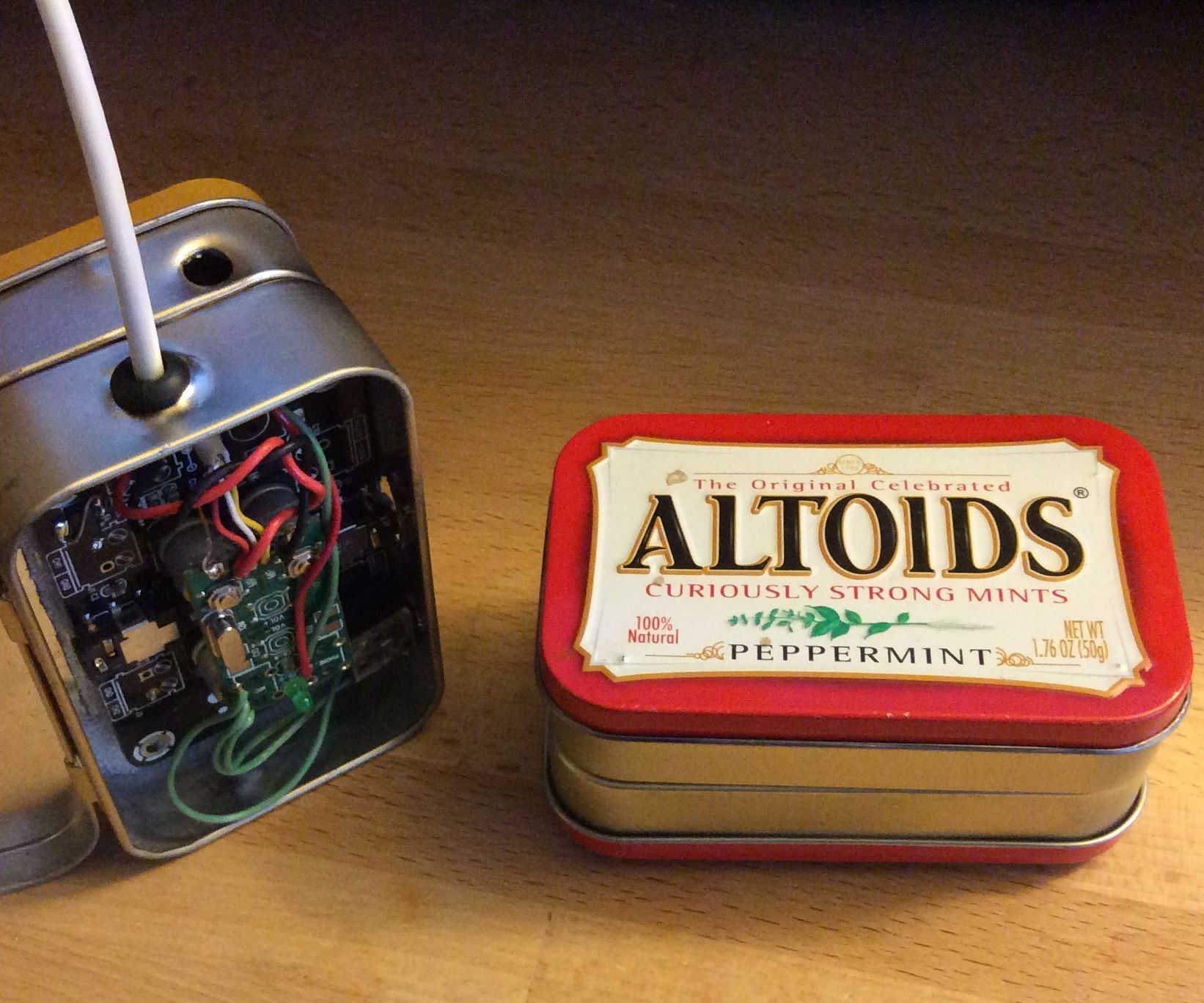

Here's my version of the mixer, using a Lucky Stars Candy tin. I plan to add a "floor" above the wiring so that I can store a short 1/8" patch cord inside as well.
