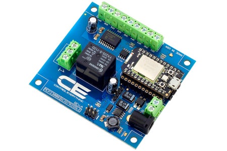

  4. 1 channel ControlAnything IFTTT Controller

First you will need to setup your relay controller which will be used to trigger the garage door opener. It needs to be connected to your WiFi network, claimed to your particle account, and connected to the internet.
  1. Make sure the Photon module is installed in the relay controller.
  2. Connect a regulated 12VDC power supply to the controller.
  3. Proceed through the setup instructions Particle provides here(Step 2 is the only step applicable, ignore steps 1 and 3) to connect the board to your WiFi network and claim it to your Particle account. Warning: Do not press the button to re-flash the tinker app to the board during setup through Particles app. This will cost you time and heartache getting the correct firmware into the board
  4. Once you have the controller connected to your WiFi network and associated with your Particle account you should see a breathing Cyan LED on the module, this indicates that it is connected to Particle's cloud and you are ready to proceed.

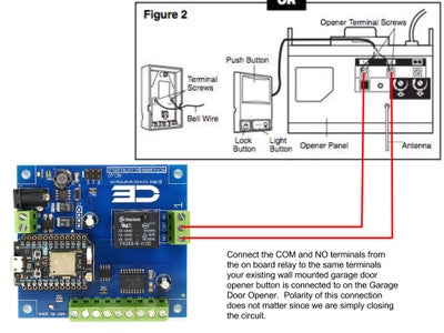

Step 3: Wire Relay Board to Garage Door
The board is all ready to go. The only thing left is to wire it to your garage door. I should note that you should never install the relay board on a garage door which does not have safety features of stopping due to obstructions like vehicles, objects, or children. Many garage doors have a beam that when tripped will stop the door. Some doors also have a feature which will stop them if they detect contact with an object.
Wire the relay board to the opener as shown in the diagram above. Most garage door openers are installed on the ceiling and are powered by an outlet above the opener. This is nice because there is usually an open outlet where the power supply for the relay board can plug in, so connect the 120VAC to 12VDC power supply for the board into that outlet to power the board. Warning: Do not connect the relay board directly to a 120VAC outlet, you must use a 120VAC to 12VDC power supply.
