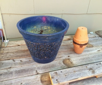

I wanted to build a cheap and easy aquaponics system to place in my existing 10 gallon aquarium. All parts were purchased from the nearest Home Depot except for the pump which came from Amazon. The entire setup cost less than $40 and took about 3 hours to put together. One thing I like about this setup is that it would work with any size tank - just start with bigger flower pots or buckets. Thanks for looking!
