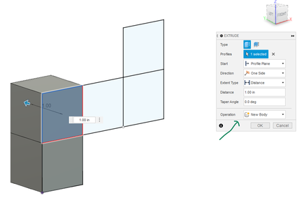

Extrude all of the squares individually by clicking 'New Body' when extruding each block. The sketch might disappear when you make the first extrude so make it visible again. Make sure to check that the extrude operation doesn't say "join" each time you extrude. If it joins, the chamfer won't work correctly.
To make another cube on the side click on the preferred face and make an extrude (you might have to make it distance -1 depending on which face you choose.)
