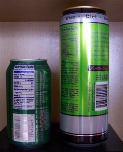

1. an empty soda can for the pot some other type of can like a veggie can and

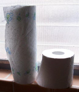

2. a few sheets of toilet paper, paper towel, cardboard or other absorbent material, including sand. (...but no synthetics!)

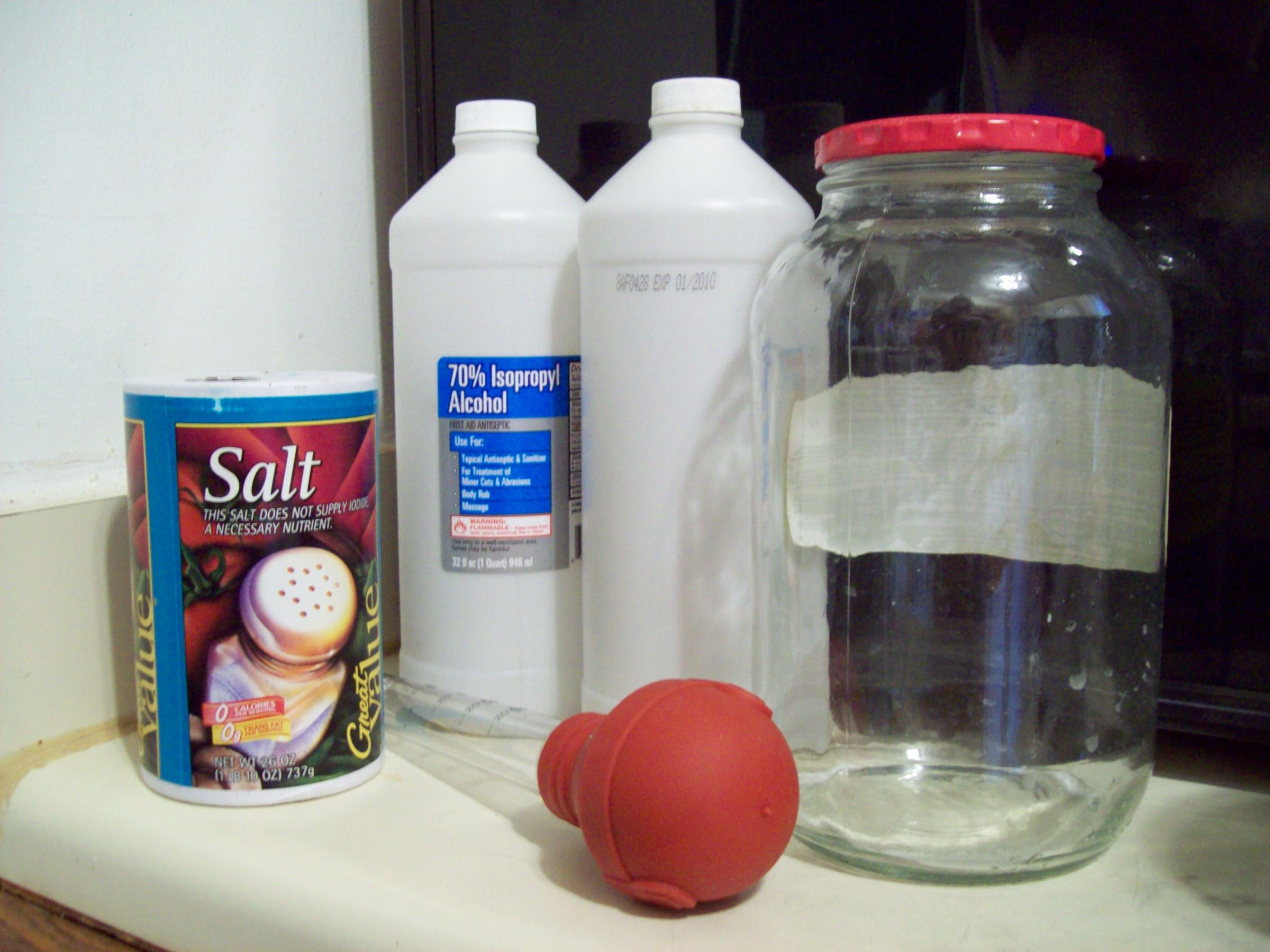

5. 91% Isopropyl alcohol. 70% may work directly and if not can be "salted out.". Fuels that float on water are not recommended.

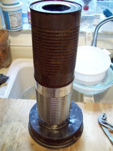

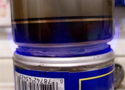

Step 1: Put It Together

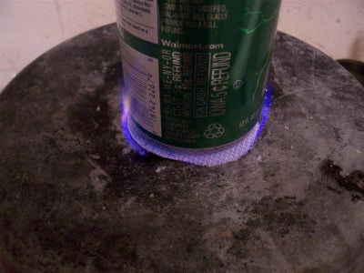

I know this looks wwwwwaaaaaaayyyyyy too simple to be a working personal pocket stove, much less the most efficient, easy to build and use, no-pot-stand-required, refuel-while-burning capable, personal pocket alcohol wicked stove in existence, but trust me! It works so surprisingly well and operates so efficiency that it makes every single laminar or pressure pocket stove I've ever used, obsolete - really. (see photos)
With a flat, fireproof surface all you need do is cut or tear 10 to 30 sheets of material the thickness of tissue, for a total thicknes of 1/4" to 3/8", to a diameter a bit larger than the can you will be using for a pot.
Soak these sheets in fuel and place on the flat, fireproof surface.

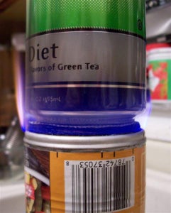

Place the pot with water to boil (or perhaps a can of vegetables or soup) on top of these sheets and then light the sheets under the pot around the edges.
If you have a second empty can suitable for supporting the pot and very close to the same diameter, turn it upside down and place the soaked sheets over the bottom. Then place the pot on top of the sheets and light the edges. A veggie can on bottom with a soda can on top worked really well for me.

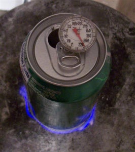

A ring of blue flame should surround the pot and then the pot should begin heating it up.
if the fuel burns up before the desired temperature is reached, no problem. Just remove the pot, replenish the fuel and put the pot back on followed by relighting.
WARNING: Be absolutely sure to replenish the fuel, only after the flame is extinguished - (repeat after me: ...only after the flame is out!).

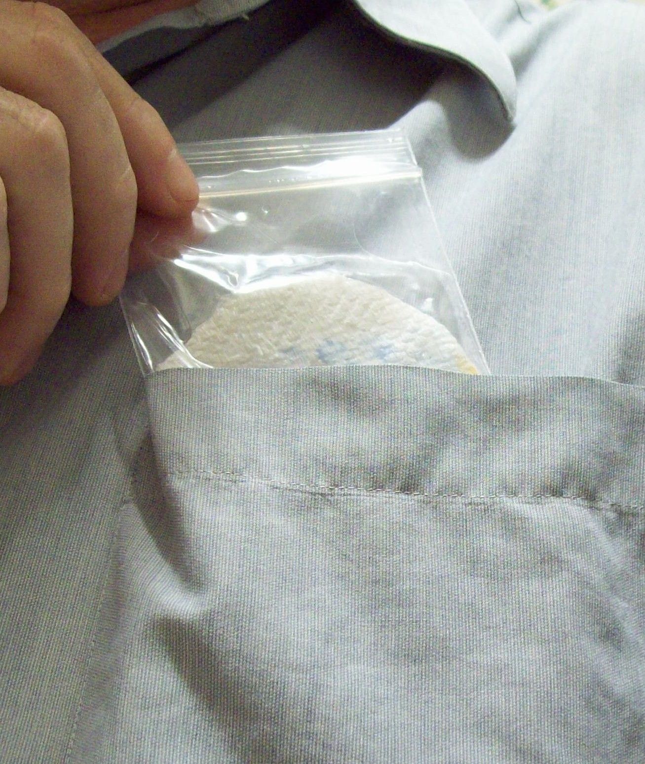

For testing though you might want to use and empty cold cream jar to store your fuel soaked absorbent material - even use it to be pre-prepared in the event of an emergency.

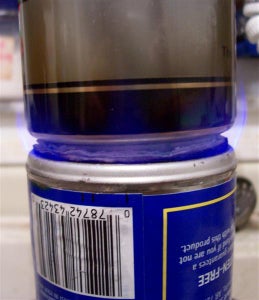

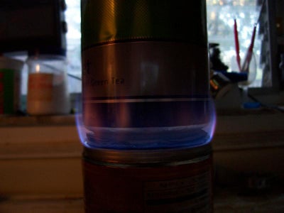

Step 2: Reverse Jet Adaptation
By placing absorbent material soaked in fuel beneath the pot inside a container with air inlet holes that are level with the bottom of the pot, a reverse jet stove can be made.
This adaptation is less susceptible to wind and water intrusion when exhaust holes are drilled near the bottom of another container placed upside down so as to enclose the pot and fuel.

    thinkahead
    thinkahead
    Reply 12 years ago on Introduction
    Here are some more pics of the one I just did using a veggie can to boil the water for two eggs and two large pork and bean cans for the stove. With exhaust holes in the top of the bottom can a prying pan can be placed on to to cook some bacon or the water can be used for coffee and the fry pan to fry the eggs and cook the bacon. I used a battery hydrometer to add fuel through the inlet holes. With this configuration I can boil water for coffee and/or boil eggs plus keep my hands warm in winter.
    100_0655 (Small).JPG100_0652 (Small).JPG100_0654 (Small).JPG100_0649 (Small).JPG100_0659 (Small).JPG100_0660 (Small).JPG
    0
    thinkahead
    thinkahead
    Also, notice the pliers for grabbing and adjusting the pot. I had to grab the opposite lip of the veggie can due to the tight fit of the pliers.
