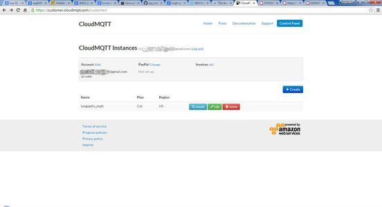

Step 4: Accounts on Cloudmqtt.com and Thingspeak.com
The board pushes temperature and humidity readings as well as the relay state to:
  • MQTT broker: Any MQTT (http://mqtt.org/) broker can be used. In my case, I have used a free online broker at www.cloudmqtt.com. You would need to create an account as well as an instance. And enter the instance details in user_config.h. An advantage of using an online broker is that it can be accessed from any network. If a local broker is used (for example, running on a local Raspberry Pi box), then it may be difficult to access it from outside the home network since incoming ports are usually blocked by ISPs.
  • Thingspeak.com: An account needs to be created on Thingspeak.com. Additionally, a channel with these three channels also needs to be created and its details entered in user_main.c:
    • field1 - relay state
    • field2 - temperature
    • field3 - humidity
Although in its present form, the board needs both cloudmqtt and Thingspeak connectivity for all functions to work properly, the code can be easily tweaked to use only one of these options.

hello, i m able to follow the steps till 6 successfully but as per the output concern i am getting like:(image- sample.jpg)
>my esp8266 is not able to connect to WIFI network since error called "fatal exception(29)" is coming eventhough i put the SSID & password correctly.(no problem with the board, works fine for both STATION & ACCESS Point interface)
>#define MQTT_HOST "m12.cloudmqtt.com" ?? is it correct (see image sample1.jpg)
>#define MQTT_CLIENT_ID "DVES_%08X" (default) is it correct ??
>#define MQTT_PORT 10981 ?? (Port??, SSL Port??,Websockets Port (TLS only)?? ) which one ??
>LOCAL char YOUR_THINGSPEAK_CHANNEL[]= "163381";(see image- sample2.jpg) is it correct ??
looking forward for ur support , thanx in advance ;-)
0
gopinath.marappan
gopinath.marappan
Reply 4 years ago
I am not really sure what the error is.
Btw, I have stopped writing firmware code by using the SDK directly. . Instead i use Arduino IDE with ESP8266 support to code for ESP8266 now. Have you tried that approach? Its a lot simpler than using the SDK directly.
0
