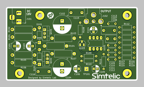

Pink noise is an essential tool in audio testing, widely used for analyzing speaker systems, room acoustics, and crossover networks. Unlike white noise, which has equal energy across all frequencies, pink noise features equal energy per octave, making it ideal for audio response testing. This characteristic ensures that pink noise offers a flat frequency response when analyzed on a logarithmic scale, providing a more accurate representation of audio systems.
We developed a this pink noise generator to meet various audio testing requirements. This device combines simplicity and performance, featuring a minimal component count for ease of assembly without compromising accuracy and usability. This pink noise generator design uses a reverse-biased emitter-base junction of a 2SC945 transistor as the noise source. In this configuration, the transistor behaves like a noisy zener diode, producing a broad spectrum of white noise.

Step 1: NJM4558 Operational Amplifier
In this design the NJM4558 op-amp is used to amplify and buffer the generated noise, ensuring high input impedance, stability, and consistent performance. At this stage above generated white noise is converted into pink noise using a 3dB/octave filter, which ensures equal energy distribution per octave over the audio frequency range.
Step 2: Power Supply & Noise Source
The unit operates on a single-rail DC power source, compatible with 12V to 18V inputs. At our testing we found that this kit with 2SC945 from Matsushita electric starts to generate output at 8.4V and above. As we noticed this behavior is changing from vendor to vendor. For example some 2SC945's (It's manufacturer is difficult to identify) produces output at 9.1V. By considering most of the datasheets we decided 12V as the safest voltage which guaranteed the output.

Step 4: PCB
The PCB for this module was fabricated by PCBWay, who generously sponsored this project. PCBWay offers high-quality PCB manufacturing and assembling services. Also, they offer CNC and 3D printing services. The pink noise generator PCB is available to order from PCBWay. Check out the PCBWay website for its manufacturing capabilities and pricing.
This kit is also available for purchase from Simtelic as a DIY kit. It is designed with through-hole components and can be assembled and tested without the need for specialized electronic assembly tools or instruments. For more details, refer to the kit's user manual provided on the Simtelic website.
