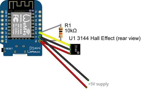

Everything just snaps together with the exception of the 2 clamp screws which self-tap into the clamp fixture and the Hall effect device which is super-glued into position. Assemble the 3144 Hall effect sensor into the base cap first. The sensor has 2 bevels marked on the front. We are exposing the back of the 3144 to the magnets in the rotor. Solder 3 fine wires onto the 3144. These should be different colours if possible. Place a small length (about 12mm) of heat shrink onto the centre terminal and offer the 3144 and the wires up to the base cap. Bend the leads of the 3144 close to the body so the 3144 sits flush, in its recess, into the base cap. Glue it in place. I used some ordinary superglue which seems to work well.
Once the glue is dry, route the signal & power leads out the hole in the base and connect the 3 leads to the Wemos D1 using the diagram above. Don't forget the 10K ohm pullup resistor and the power input leads. Although the Wemos is a 3.3V device, it seems to tolerate the 5V 3144 OK. If you are nervous about this, you can use a small 2-resistor divider combination to cut the pulse size and pull up the output of the 3144.
There is a cutout provided in the arm to hold the wires. Secure with small zip-ties.
Before you push the magnets in, follow the instructions in "Final" and flash the Wemos with the sketch. Check the correct polarity of the magnets by moving them across the 3144 and check that the onboard LED flashes as you do. The 3144 is polarity sensitive. The bearings and magnets then just push into the rotor and shouldn't need any support. The shaft also simply pushes into the base cap.

Assembly is easy. Wire and attach the 3144 to the frame using the same method as in the anemometer above. Again, the "back" ( not the face with the chamfers) faces the magnet. Push the magnet into the recess on the bucket. The bucket just sits in the 2 U shaped rails on the inner sides of the frame. Once the frame is screwed to the barrel, the bucket is trapped and shouldn't fall out easily.
Wire the RG to the D1. The signal cable connects to the D5 pin but, like the Anemometer, you will need a 10K pullup resistor to the +5V pin.
