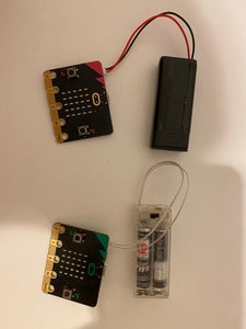

- Micro:bit (Pet & Receiver)
- Battery Pack
- Tape/ Hot glue (preferably tape)

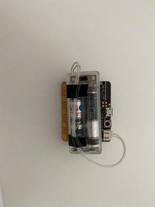

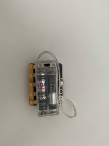

- Insert your battery in your battery pack for each micro:bit as shown in picture number 2.
- The battery pack I use is ABC Power size AAA
Micro:bit (Pets) : (Taping the micro:bit and battery pack together)
- Prepare the materials as shown in picture number 3 : Tape (Duct tape), Micro:bit and a ribbon.
- Place the battery pack behind the micro:bit as shown in picture number 4.

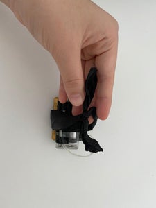

- Tape at the edge of the wire of the battery pack as shown in picture number 5.
- Place a tape behind the micro:bit (on the battery pack) as shown in picture number 6.
- After you tape everything together, it should be able to stand up and look like picture number 7.

- Fill the ribbon between the wires of the battery pack, as shown in picture number 9.
- Tape the ribbon on the side of the battery pack as shown in picture number 10.
- Tape the other side of the ribbon on the battery pack as shown in picture number 11.

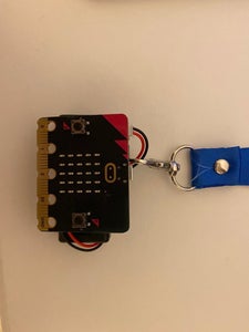

Micro:bit (Receiver) : (Taping the micro:bit and battery pack together)
- Tape the wire to the battery pack as shown in picture 15.
- Tape/ Glue the micro:bit to the battery pack as shown in picture 16.

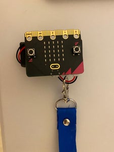

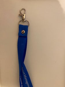

- Attach a necklace (used for ID Card) as shown in picture 17, on the wire of the battery pack as shown in picture 18.
- At last it should look like picture 19.
- However, the micro:bit for the receiver does not have to be decorated unlike the micro:bit for pets.
