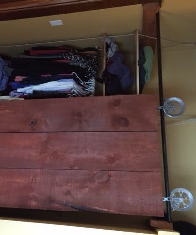

Step 3: Modular Sections
The modular workbench sections were built out of smaller pieces of cedar to help save on costs.
- At this point in time I forgot to take intermediate pictures, so all I have to show are the final views. There should be enough in these pictures to depict how it was put together with some legitimate guessing.
More bells and whistles:
- Modular section is on caster wheels so the sections can be mobile. Chose what I hope are non-marking wheels.
- some random screws jutting out act as fancy tool hangers
- left over lumber makes a shelf.
- Modular work surface is not attached, but is more of a lid so that I can see and find the stored items easily.
- Jars lids screwed to bottom of modular working surface to act as some sort of compartmentalized storage (mostly screws/nails)
- Magnetic tool hanger. Made of a flat metal bar screwed to the wood. Bar magnets lined up in a row on the metal bar. Tool were hung by the tips (except the heavy ones which hang on the ground). This system will probably cause your tools to become magnetized, which can be helpful.
