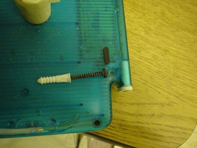

Keyboard:
1) Decide where you want to position the mice. Drill a hole all the way through the keyboard at this point. The hole should allow the wood screw to get through without cracking the keyboard.
2) Drill a second set of holes on the back next to the mouse mounting holes. The second set of holes is to hide the end of the mouse cord in, so it should have the same diameter as the mouse cord, and should be close enough to the mouse mounting holes, that the dowel will cover it.
3) Remove the black screws on the back of the keyboard from next to the USB ports. Enlarge the holes such that a) the wall mounting screws can fit through, and b) the heads of the wall mounting screws will be sunken into the back. (see image)
