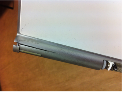

A little introduction: my Apple-keyboard (picture above) happened to lay for about
1,5 years in the package with the batteries inside. Of course eventually electrolyte spilled out of the batteries and filled up the battery compartment, chaining its lid to the keypad.
Using a coin or a screwdriver, as tools to open the lid, equally failed

Step 10: Open Your Keyboard
Then we unbent the incised part carefully and saw the thread filled with electrolyte
and the whole battery compartment
