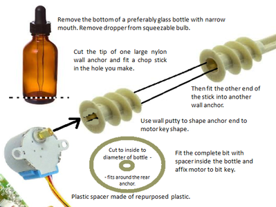

Step 4: Automatic Fish Feeder
How a step motor works: http://en.wikipedia.org/wiki/File:StepperMotor.gif
The 5V stepper motor (Fish Feeder) has (4) pins wired to a different Arduino pin. Then electromagnets are wired off set: (10,12,11,13) and when they are individually called in the program, which defines how many steps are to be taken, the electromagnets are energized and attract the gears teeth for the amount of steps defined. Our stepper is set to -1500 steps to cause a counter clockwise motion of the plastic auger bit inside the feeder. If the number was positive, it would go clockwise.
