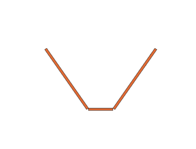

  5. I arrange 3 same-color parts at 125 degrees to make my design.
  6. Similarly, place other parts. Now I have 15 different small assemblies of the same color.
  7. Now I arrange them in decreasing angles to make an internal archimedean spiral design.
  8. I started from 148 degrees on the outer part and decrease to 125 degrees while going inside.
