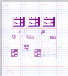

Step 2: 2D CAO
I used Inkscape to design the components of the board game.
