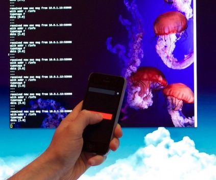

Next, you will need to open up Putty or eTelnet to communicate to the RaspberryPi through Telnet.
To do this type in your Pi's IP address and tell it to connect though port 7777. Put in the username and password stated above.
Once connected you should see: "ROVER by GREG!" Telling you communication is ready and succesfull
INSTRUCTIONAL PHOTOS ABOVE:
I used the eTelnet app to control my rover with my iPad. It's easier than using a laptop!
