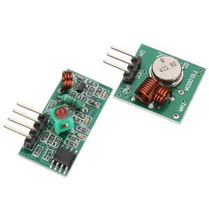

Hello world! Today i made a example for the FS1000A 433mhz Wireless Transmitter and receiver set. I am testing these for my website and will set them for sale on the website soon. The example shows you how to turn on a relay, led and buzzer with a button using 433Mhz wireless communication. You could use this example as a panic alarm! You wear the remote on you, hit the button and alarm will go off. Simply add a alarm strobe with sound to the relay for example. Follow the next step for the Schematics, Codes & Parts list.

Simply wire it up like the schematic shows, I added 9 volt batteries to the Schematic but you don't need them to test.
Parts list:
  • 2x Arduino uno.
  • FS1000A Transmitter & receiver set (add 17cm antennas, i used jumper wires.)
