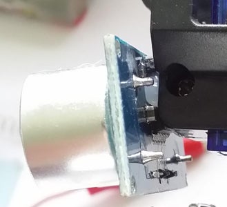

Step 3: Ultrasonic Distance Servo Mounting
Mounting the delivered servo and ultrasonic distance sensor requires manual work, since it is not supported out of the box.
  • Trim the two longer arms of the servo connector, so they have only 3 holes and their ends are narrow enough to fit in the base. Use the two 3mm countersunk self-tapping screws to attach it at the base.
  • Set the servo to 90 degree by using a program or choosing the middle position between the two end stops - attaching the two-arm servo connector helps finding the right position.
  • Use the panhead screw to attach the servo connector to the servo.
  • Use the two 7 mm screws to connect the two halves to clamp the servo.
  • Strap the ultrasonic sensor, pins up, to the mount with hot glue or twist tie.
  • Widen the front holes of the base with a scissor, a tweezer or a similar tool for the M3 screws to pass through.
  • Fasten the base with 2 screws in the front slot and position it in the center.
  • Mark the position of the back holes, drill two 2 mm holes in the top deck and use the M2 screws of the servo set for it. Using only the 2 front screws has the risk of breaking the front slot if you accidentaly apply to much force to the sensor / servo structure.

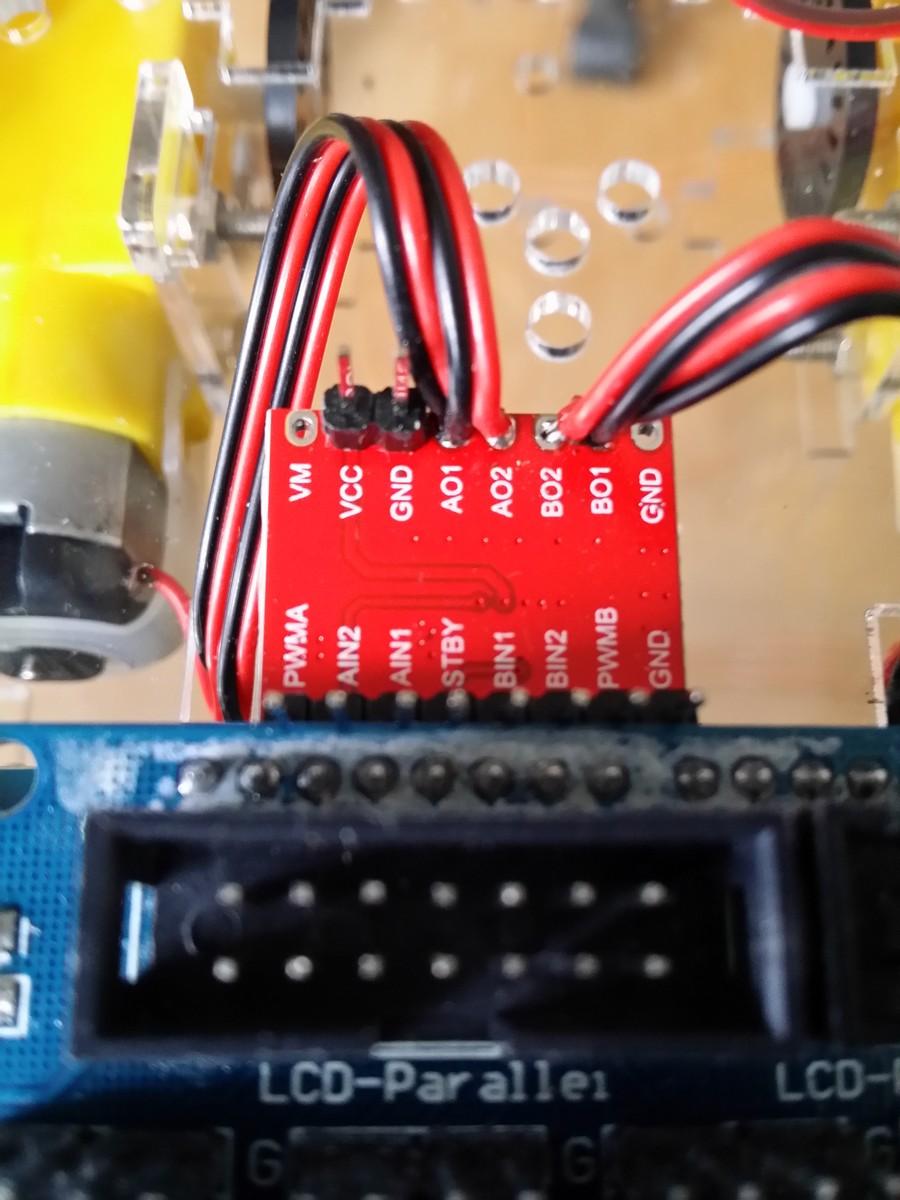

As supply voltage we have 6 volt or even only 4.8 volt, if we use NIMH batteries. In this configuration, it is no fun to use a L298 motor driver, which has a loss of 2 volt. The TB6612 driver breakout board costs around 3 to 5 € and has no loss!
Nevertheless, the L298 driver is supported by the motor control library too.

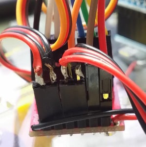

  • To avoid mistakes while connecting theTB6612 to the UNO board, you can remove the unused pins of the pin headers before soldering, like in the picture.
  • To reduce additional loss, solder the battery plus and minus cables directly to the VM(otor) and GND terminals of the TB6612 driver breakout board.
  • If you solder the the motor wires to the (A|B)O1 and (A|B)O2 terminals you may reduce further voltage losses, but then you cannot easily separate the two decks after soldering. For this, solder the motor wires to female pin headers.
  • Do not forget to connected the STBY terminal to the VCC terminal on theTB6612 driver breakout board, since we do not require this functionality and do not want to use an Arduino output for it.
  • For optional battery voltage readout, you can solder 100 kOhm between VIN and A2 and 10 kOhm between A2 and ground.

The actual connection between the Sensor Shield and the servo, the ultrasonic sensor and the motor driver is of course software dependent. Here are the definitions used by the PWMMotorControl Arduino library. The line marked with AVR (UNO) (line 37) shows the relevant connections for us.
To connect the motor driver you can use the 15 cm cables inteded for the IR obstacle detection curcit or use extra12 cm female-female dupont wires.
Do not forget to connect the Arduino VCC and GND with the VCC and GND terminals of the TB6612 board.

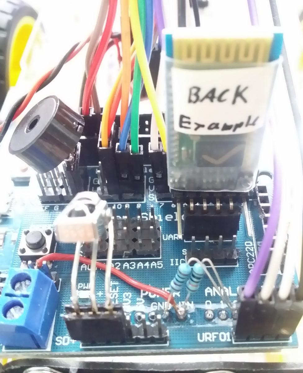

Step 10: Modify SensorShield for Bluetooth Module HC05
For Bluetooth control, I use a HC05 bluetooth modul and connected it to the UART pins of the Sensor Shield.
To avoid another set of cables, I changed the original male UART pin header row to a female row. Desoldering (and soldering) can be done by heating all 4 pins simultaneously, with the help of a lot of solder.
Step 11: Smartphone Control
If you have added a bluetooth module, you can control your car by your smartphoneusing the RobotCarBlueDisplay example of the BlueDisplay Arduino library. On your Android smartphone you need to install the Android BlueDisplay app.
The Bluetooth module can be modified by means of the BTModuleProgrammer example from the BlueDisplay library to have a unique name and to support 115200 baud.
Do not forget to remove the Bluetooth module during programming of the UNO, otherwise you will get errors like:
avrdude: stk500_getsync() attempt 1 of 10: not in sync: resp=0xa5
Take care, that the line with the right configuration e.g. #define TBB6612_4WD_4AA_FULL_CONFIGURATION is activated before compile!
