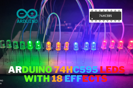

Introduction: Arduino 74hc595 Shift Register | 16 Led Chaser With 18 Effects
Hello again,
I am thinking about how to control more than 20 led with Arduino Uno because Arduino Uno only has 13 digital pins. So how It's possible? That's why I came with the shift register 74hc595. We need only 3 Arduino digital pins to control LEDs using 74hc595 shift registers. There are 3 part of shift register tutorial.
Control 8 leds.Control leds brightness.Control 2 shiftRegister with led effects. I will explain coding too.

Step 8: Control 16 Leds With 18 Effects.
All the connections are the same as before the change is we are using two shift registers.
Connect the power connection to other breadboards. Add extra 8 LEDs and resistors of 220 ohms. Now attach a shiftRegister and connect the power connection same as the first one.
Next, connect shiftRegister pin 14 to pin 9.
Connect shiftRegister pin 13 to 13.
Connect shiftRegister pin 12 to 12.
Connect shiftRegister pin 11 to 11.
After that, connect the Arduino to shiftRegister.
Arduino pin 2 is connected to shiftRegister pin 11.
Arduino pin 3 is connected to shiftRegister pin 12.
Arduino pin 4 is connected to shiftRegister pin 14.
Arduino pin 5 is connected to shiftRegister pin 13.
Now, deliver the 5v to the breadboard via an Arduino.
Next connect the output pin to leds
Connect your arduino into the computer and upload the code.
Now enjoy the effects.
