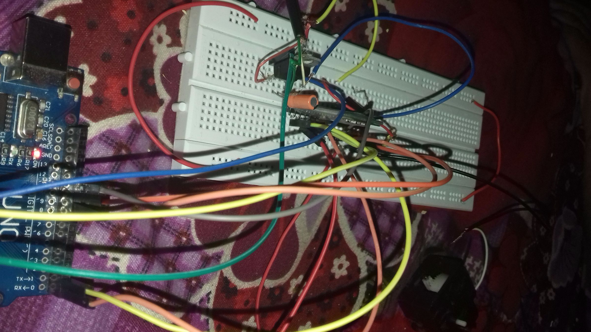

I have made this circuit but when i enter passward then it says door is open but motor doesnt work
Reply 4 years ago
check if the grounds are connected to each other or not. Also make sure that RX pin of HC-05 is connected to TX of arduino And Tx or hc-05 is connected to RX of arduino
