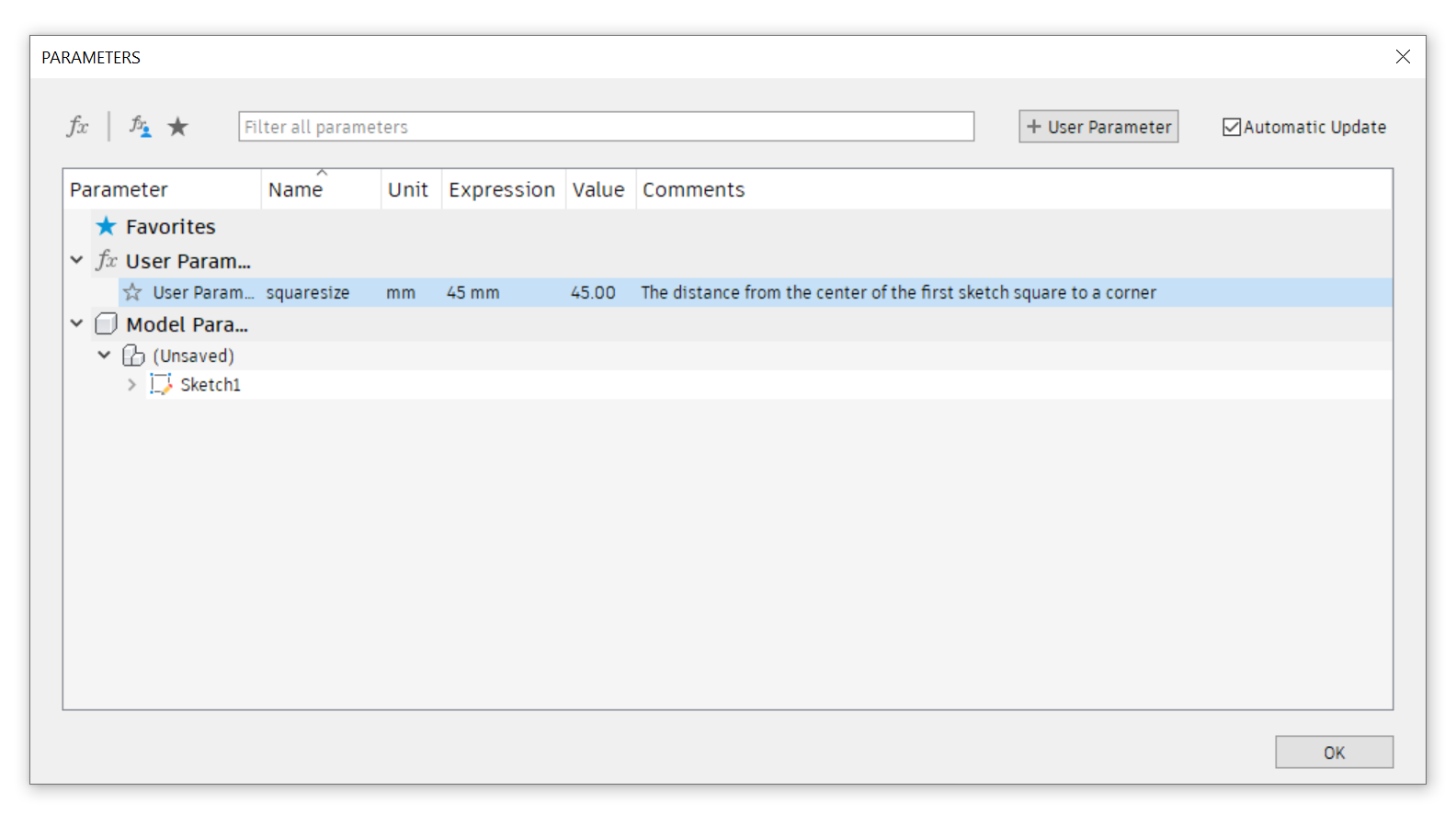

One of the most powerful tools in Fusion 360 is the timeline, which allows for parametric modeling -- using variables instead of numbers, that way if you want to change the diameter of each of the buttons' holes, for example, you can do so by changing one single term, rather than needing to go through one-by-one and widen the holes.
To access user parameters, go to Modify < Change Parameters < + User Parameter. Then, you can create your variable, define what units it will use, and specify a length, angle, etc.
I added several parameters as I went along to allow myself to tweak the design. I was really glad I did this, because there were several times that I needed to make walls bigger, expand holes, etc., and I was glad I didn't have to go through and do it manually.

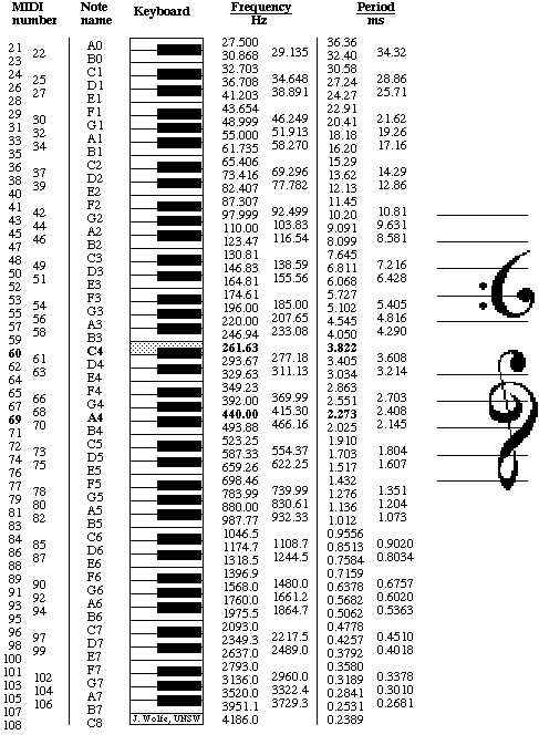

It's not super important if you hook your LEDs up to different pins than the ones I used, but it is important that the Arduino knows which pins are which color, so it can play the correct tone. For this part of the project, I went to my parents' house, dug an old Simon game out of their game closet, changed the batteries, and played it with a tone analyzer app open on my phone. From this, I was able to get the exact tones. There are two sets of tones that Simon used. Some of the original Simon games used a B♭ minor chord, but the more recognizable variant is an A major chord, the notes and frequencies of which are:
Green: E4 (329 Hz)
Red: A3 (220 Hz)
Yellow: C#4 (277 Hz)
Blue: E3 (164 Hz)
For the purposes of this project, these tones may also sound better either shifted up an octave, or in the B♭ minor chord. Totally up to preference. Here's a note chart if you want to play around with other notes and frequencies, here's a chart that will help you connect notes to frequencies.
