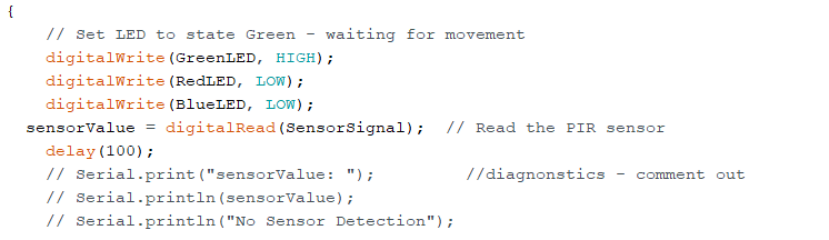

The first thing I do is set the green LED on (high) and all others off. I also read the PIR sensor and digitally read the PIR pin and place that values into the variable sensorValue. If the PIR is HIGH, there was movement and LOW if nothing detected. The last several lines I had in just for diagnostics so that I could read using the Arduino serial monitor. Got the whole thing working so I commented out. I like to keep the text in case I mess with the code and then I can use later.
