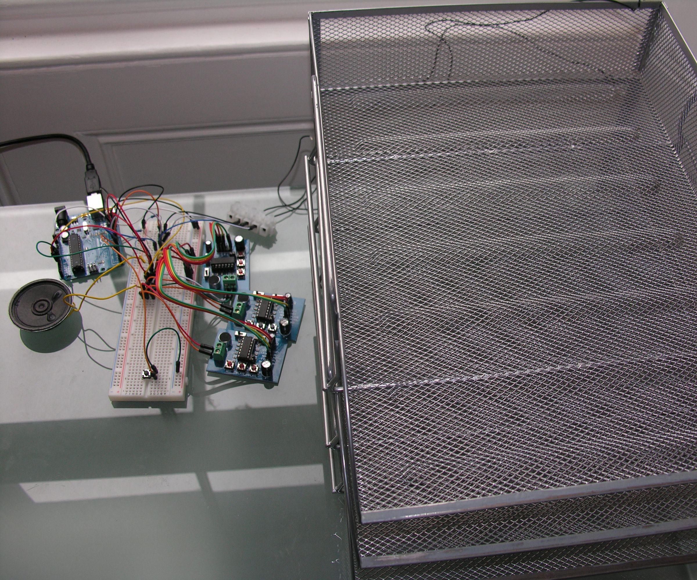

Step 9: Connecting Your Relay Shield
You will need:
Wikipedia explains that a relay is
The Relay Shield that I purchesed consisted of the boards and pins and sits on top of the Arduino. This means that we need to take the out the pins connected to the Arduino and remember what jumper pins were connected to what Arduino pin number.
Disconnect the USB from the Arduino
To make sure the Relay Shield does not touch the Arduino USB port, place a couple strips of electrical tape to cover it.
Please view the images on how to attach the Relay Shield to the Arduino.
The Relay connection to the Arduino wasn't great so I used an elastic band to hold them together. If you do have access to soldering equipment, you can solder the relay shield headers on to the relay shield. This should give it a better connection.
As we are going to be putting in the fairy lights next , we can remove the LED. This was just an intermediate step.
Once the Relay Shield is connected we can put the jumper pins in to the Relay Shield pins holes.
- Relay Shield
- Electrical tape
An electrically operated switch. Many relays use an electromagnet to operate a switching mechanism mechanically, but other operating principles are also used. Relays are used where it is necessary to control a circuit by a low-power signal (with complete electrical isolation between control and controlled circuits), or where several circuits must be controlled by one signal.We need it in this case as we are trying to control high-power mains fairly lights with Arduino's low-power signal.

Step 11: Connecting Your Fairly Lights
You will need:
Once our relay is set up it is time to connect the fairy lights.
Since we are controlling pin 4 and pin 7 we need to make sure that we are using the corresponding relays 4 and 1 (we will only be using 2 of the relays out of the 4 as we only have 2 sets of lights to switch on and off).
You are now all set up and ready to test it!
- Small flat head screwdriver
- Make sure the fairy lights are NOT plugged in to the mains
- Relays have 3 connections
- Relay switch is default open (no connection)
- Common - connected if either default open or closed
- Relay switch is default closed (connection)
- Unscrew your first set of light cables from the terminal block (making sure it is not the ground cable)
- Screw in one end to common relay point
- Screw end the other end to the open relay point
- Repeat for your other light cable (again making sure it is not the ground cable) in to the other set relay
- Keep the ground cable connected with the terminal block.
