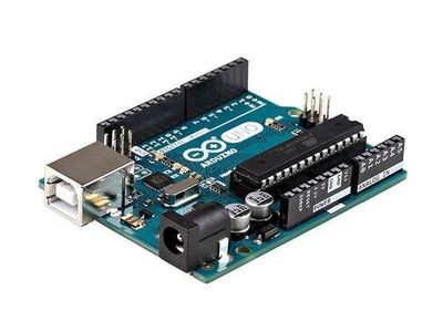

  • Arduino UNO (or any other Arduino)

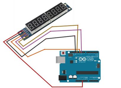

Step 2: The Circuit
  • Connect LED module pin[VCC] to Arduino pin[5V]
  • Connect LED module pin[GND] to Arduino pin[GND]
  • Connect LED module pin[DIN] to Arduino digital pin[11]
  • Connect LED module pin[CS] to Arduino digital pin[10]
  • Connect LED module pin[CLK] to Arduino digital pin[13]

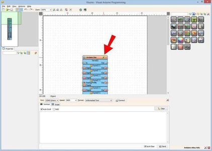

Step 3: Start Visuino, and Select the Arduino UNO Board Type
The Visuino: https://www.visuino.eu also needs to be installed. Download Free version or register for a Free Trial.
Start Visuino as shown in the first picture Click on the "Tools" button on the Arduino component (Picture 1) in Visuino When the dialog appears, select "Arduino UNO" as shown on Picture 2

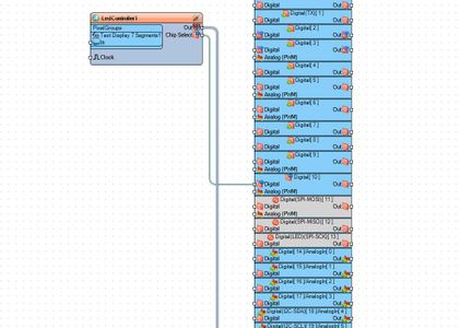

Step 4: In Visuino Add,Set & Connect Components
  • Add "Maxim LED Display Controller SPI MAX7219/MAX7221" component
  • Doble click on the "LedController1" and in the "PixelGroups window" drag "Text Display 7 Segments" to the left side
    And in the properties window set Initial Value to: Arduino!
    Note: Text on this Display is limited to a certain characters, so play with it to see what kind of words you can display.
  • Close the "PixelGroups window"
  • Connect "LedController1" pin Out SPI to Arduino Pin SPI [In]
  • Connect "LedController1" pin Chip Select to Arduino Digital Pin [10]

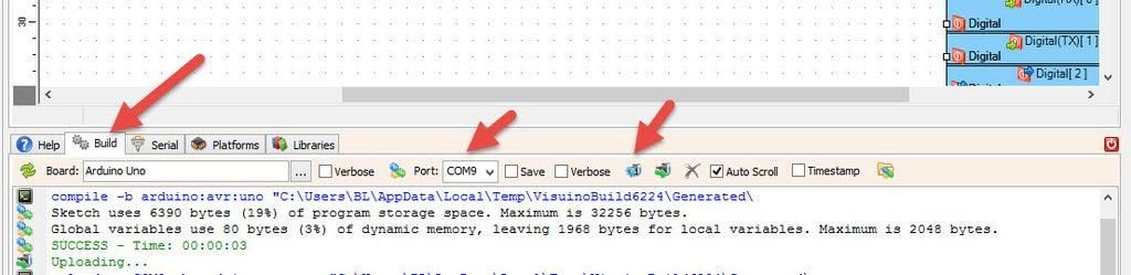

Step 5: Generate, Compile, and Upload the Arduino Code
In Visuino, at the bottom click on the "Build" Tab, make sure the correct port is selected, then click on the "Compile/Build and Upload" button.
