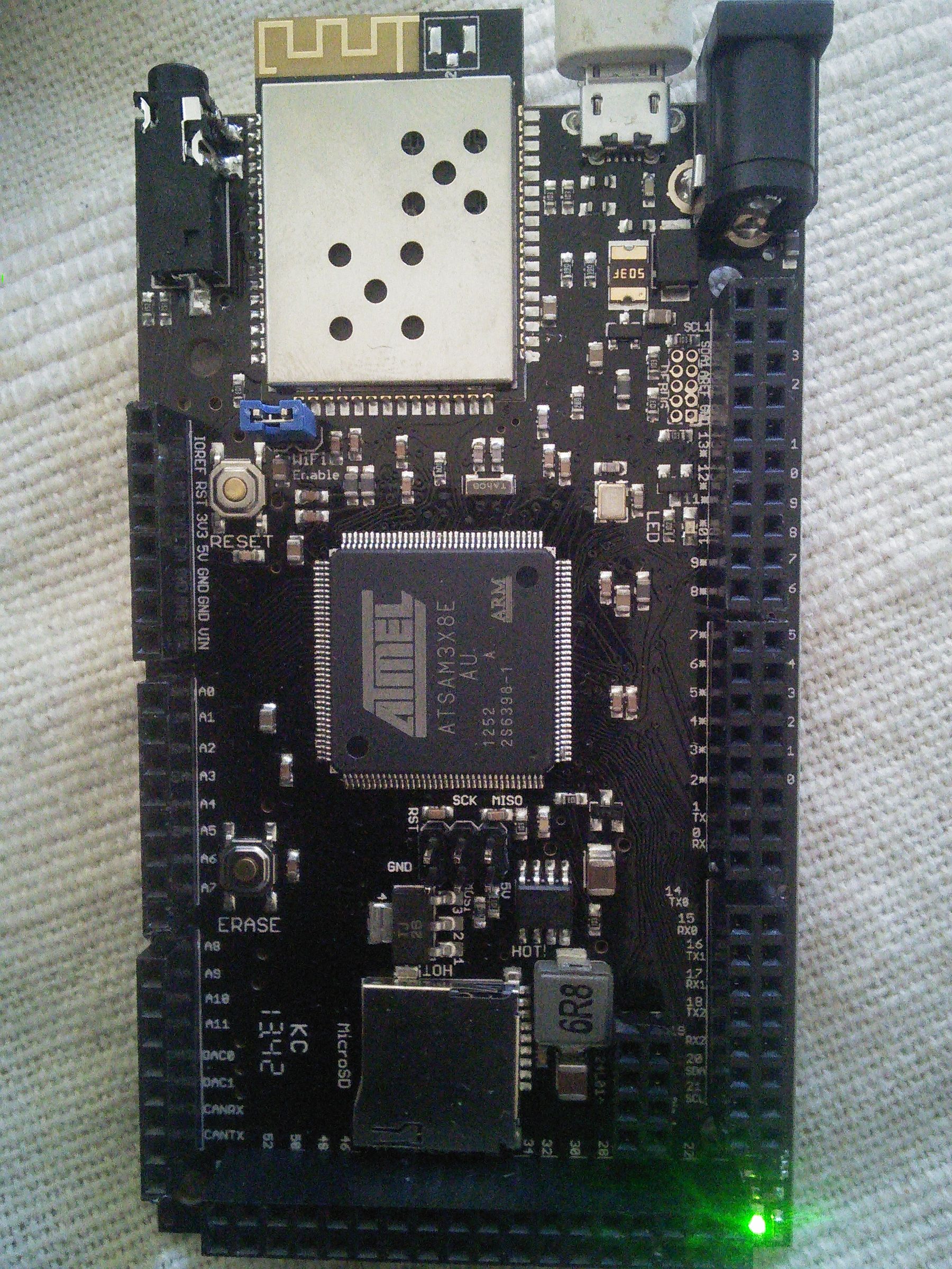

I wanted to build a guitar input circuit for an arduino due ADC.
The circuit is intended to be connected to an arduino due analog pin. These ADC input pins require a voltages between 0 and 3.3V when the guitar pickup output is typically 100-500mV AC centered on 0V.

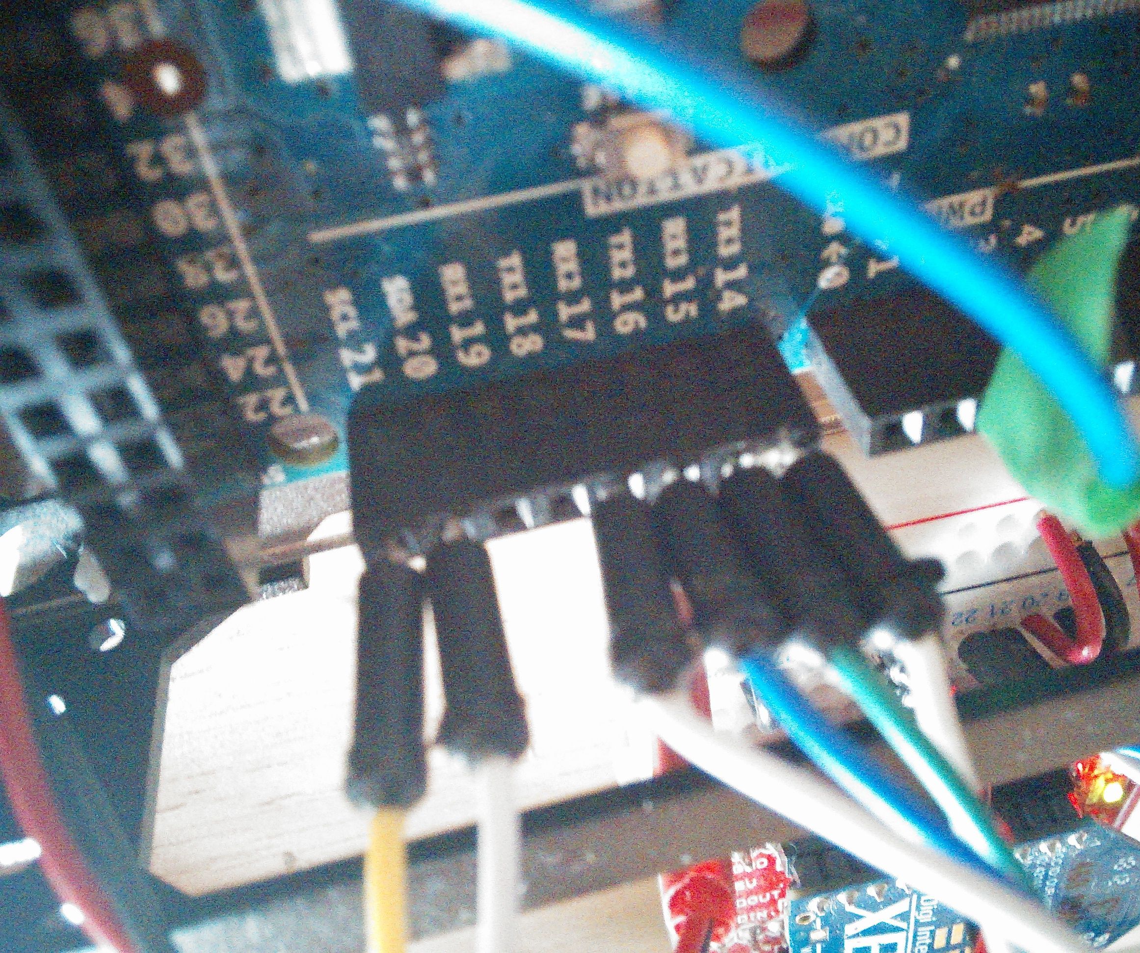

Step 2: Build on Breadboard
I built the circuit on some breadboard. Here are some pictures. I think its now safe to connect to the arduino due analog pin. I didn't bother to put in the gain boost switch.
