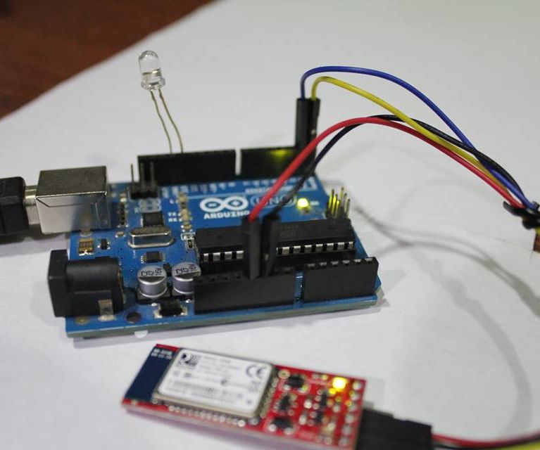

Step 2: ASSEMBLE THE ELECTRONICS
Watch The Steps To Do Pcb Printing
TONER TRANSFER METHOD
IRONING METHOD
Then Install all The Components In The Enclosure As Per You'r Needs..
Please See The Photos To Get The Ideas.
You Can Even Make Your Own Relay Board....
Do The Wiring As Per The Circuit Diagram Its Very Simple.
Sorrry i have connected only 8 relays there is an option for 9 relays you need to add one more ULN2803.
Please Watch the video to see the 2-way switch wiring, and see the photos.
the only thing you need to change in the switch wiring is that instead of the 1st switch connect the relay which even has a 3 pins.
I have even housed the powersupply in a smps cabin.
ill suggest to see all the photos i've posted to get all the idea
