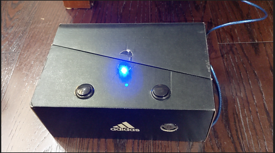

The design was inspired by a product that is also presented on Instructable called "Arduino Basics with Night Light" (https://www.instructables.com/Arduino-Basics-With-...). Originally, the device is only allowed to change the LED lights by pushing down a button; after adding the codes and circuits (added: a speaker to notify the user for using recommended relatively peaceful color-blue/a second button to turn the machine off at any time), the device is now capable of lightening the room, notifying you for turning on, and switch the machine off.

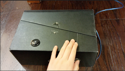

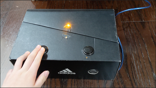

When utilizing this device, if wanting the night light to be bright yellow, simply only push the start button once, then there won't be a combination of sounds reminding you. Under this situation, you can press the second button to turn the machine off. If wanting all functions, push the start button twice until the LED changes to blue, and you will hear a notification of turning on the night light with recommended relatively peaceful color (blue). After enjoying your dream overnight, you can push down the second button for turning off the entire machine as well.

First, holes for the buttons. There are 2 buttons for this machine in total, therefore, we will need to carve 2 holes on the top surface of the box. When the diameter of these holes is 3.1cm, the buttons can be fixed on the top surface the best. If accidentally cut them too widely, you can stuff some thin cardboard between the gaps to fix the buttons at the position. (Note that any place on the surface is acceptable, as long as they are on the top surface of the box) (If feeling the button to be insecure, can use tape to fix them in the position)
*If you think you may confuse yourself about the functions of each button, you can use a marker to write down "on" or "off" on the box in the area above the button to differentiate them*

Place the Arduino and breadboard entirely into the box, and put the buttons, LED lights, speaker, and microUSB to USB cable to each corresponding hole. (According to the photos)
*Tape should be prepared aside for securing each component's position if needed*
Step 7: Done!
Congratulations, you've finished making your device.
Connect your Device with your laptop, and check out the video to see if your machine works correctly!
