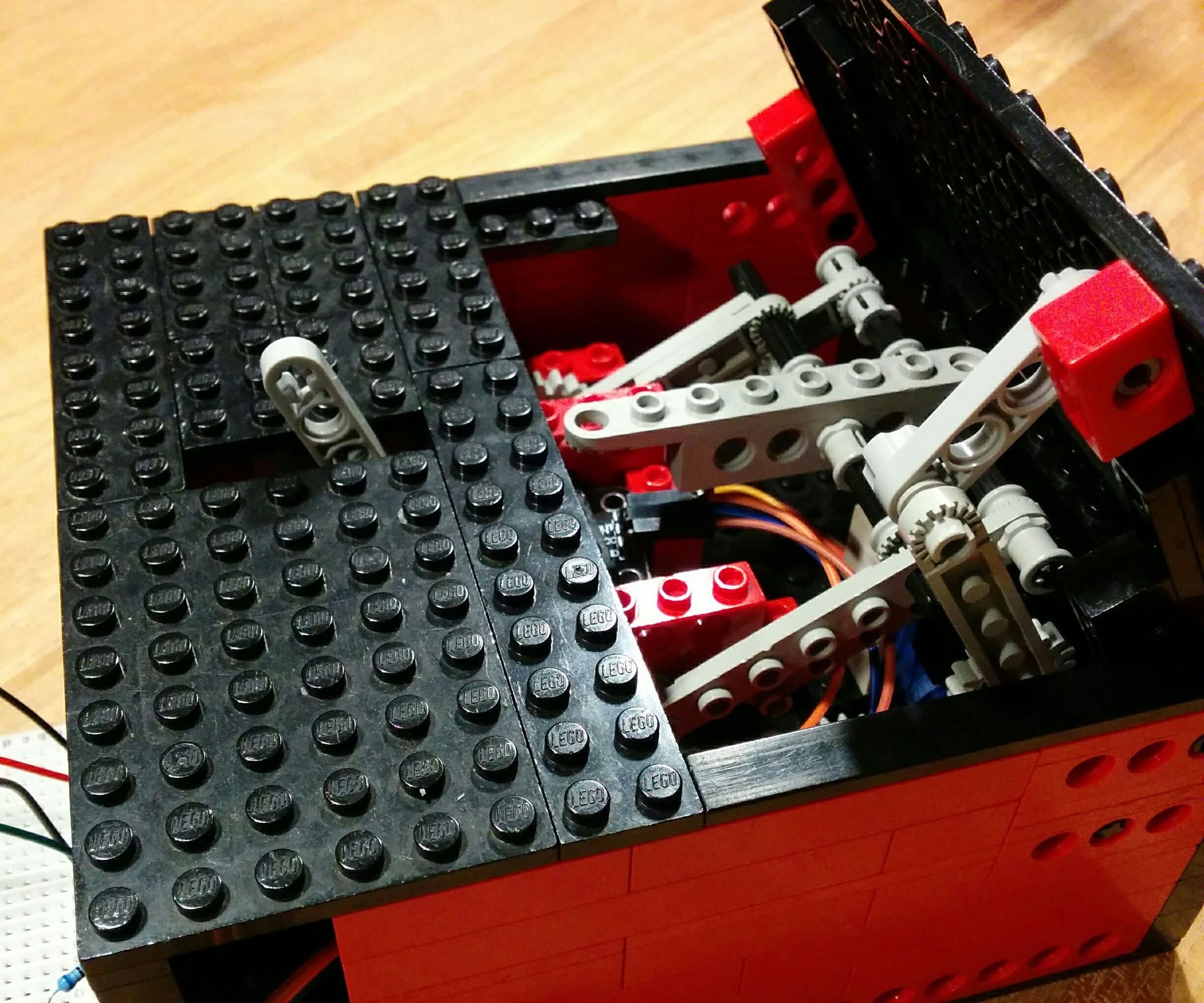

Step 2: Build a Car
I used Lego to build the car, to connect the motors to the lego I used some metal screw-threaded rod.
