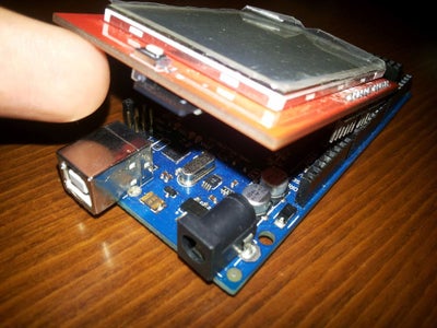

Step 1: Assembly
Put the 2.4" TFT LCD shield onto Arduino MEGA with its suitable pins directly to Arduino.
DHT11's second pin is which we need, put this data pin to Arduino MEGA's Pin number 17
You may use tiny bread board and tiny cables to make connections.

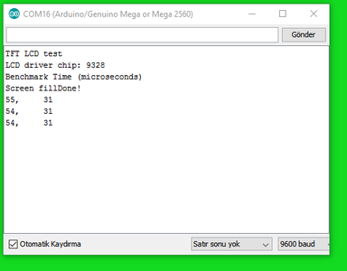

Step 3: Get the Results
The main algoritm is taking the recent temperature and humidity values from related environment which the sensor has located, we see the results on the display. Since the display is multicolored, I add colored response when it is hot or cold. These are:
if (DHT.temperature > 30){
tft.setTextColor(RED); }else if (DHT.temperature > 27 || DHT.temperature < 30) { tft.setTextColor(YELLOW); } else if(DHT.temperature < 27 || DHT.temperature > 10){ tft.setTextColor(BLUE); } else if (DHT.temperature <10){ tft.setTextColor(CYAN); } else { tft.setTextColor(GREEN); }
This means that:
1. If temperature is high from 30 celcius degree, make the displayed temperature line as red.
2. If temperature is above 27 below 30, make the displayed temperature line as yellow.
3. If temperature is above 10 below 27, make the displayed temperature line as blue.
4. If temperature is below 10, make the displayed temperature line as cyan.
5. If none of these first four statement comes true, just make it green. (This is for using else statement in the code on purpose)

Step 4: BONUS: Let's Save the Values to the SD Card
I haven't got a small SD Card reader shield for Arduino boards as SPI, but I have got ethernet shield which is Arduino Mega compatible. This shield has sd card reader slot. My idea is saving humidity and temperature values to the sd card with using ethernet shield's sd card slot.
So, Combine Arduino MEGA and Ethernet Shield. Then, add the TFT LCD Shield, also add DHT11 as mentioned on first steps of this instructable.
Download the code for Arduino IDE below.Upload it to your Arduino MEGA. You may close your computer's Bluetooth connection in order not to get any errors while you upload the code by Arduino IDE program.
You need to format your sd card as FAT32 or FAT to use for Ardunio. Please check my sd card status while I use actively from attachment. You need a SD Card reader with usb cable attached to your pc to see the text file inside.
