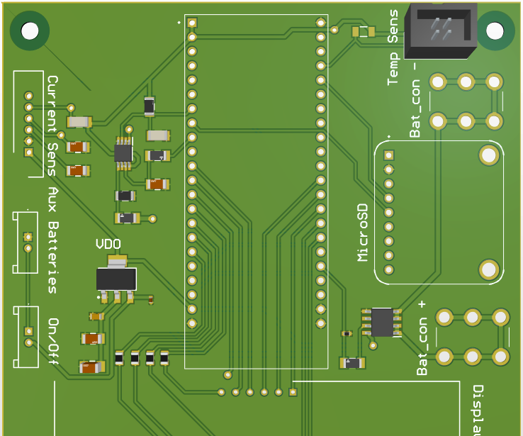

The GP21 Acquisition Board is a PCB made with the purpose of serving as a Shield for the Arduino Mega+Wifi. This PCB is used in both our team cars, GP21 and GP19, that competed this year in two GreenPower F24+ competitions, Final Iberica and International Final in Goodwood.
As expected, the improvements made in this PCB proved to be useful as we will see later in another section, where all the flaws and advantages will be presented.
The software KiCad was used to create this PCB as it is open source and easy to learn and use. The PCB was supplied by JLCPCB, a high quality, low cost PCB manufacturer.

The dimension of the Shield is 109.576x65.151[mm], with 2.9 mm of thickness and two layers, slightly bigger than Arduino Mega(101.86x53.61 [mm]).

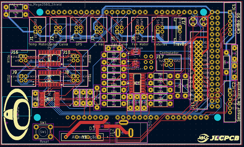

Step 3: Flaws and Advantages
  • The RTDs presented before were not used in this year races, but the advantage of already having the circuit implemented on the board demonstrates the future proof characteristic of this PCB. To complement, the hall sensor was not used due to mechanical constraints, but the circuit is also on the board.
  • The GPS proved to be very useful as the hall sensor was not used and the only way to know the position, velocity and travelled distance was with the GPS.
  • The Electronics Box was also an excellent idea to protect the PCB and wires connected to it, providing also stability for the connections.
  • When it comes to flaws, unfortunately the sensors that work with the SPI protocol, SD Card Reader, Steering Wheel Encoder and TFT didn't work properly during the races, most likely because of the wires capacitance.
