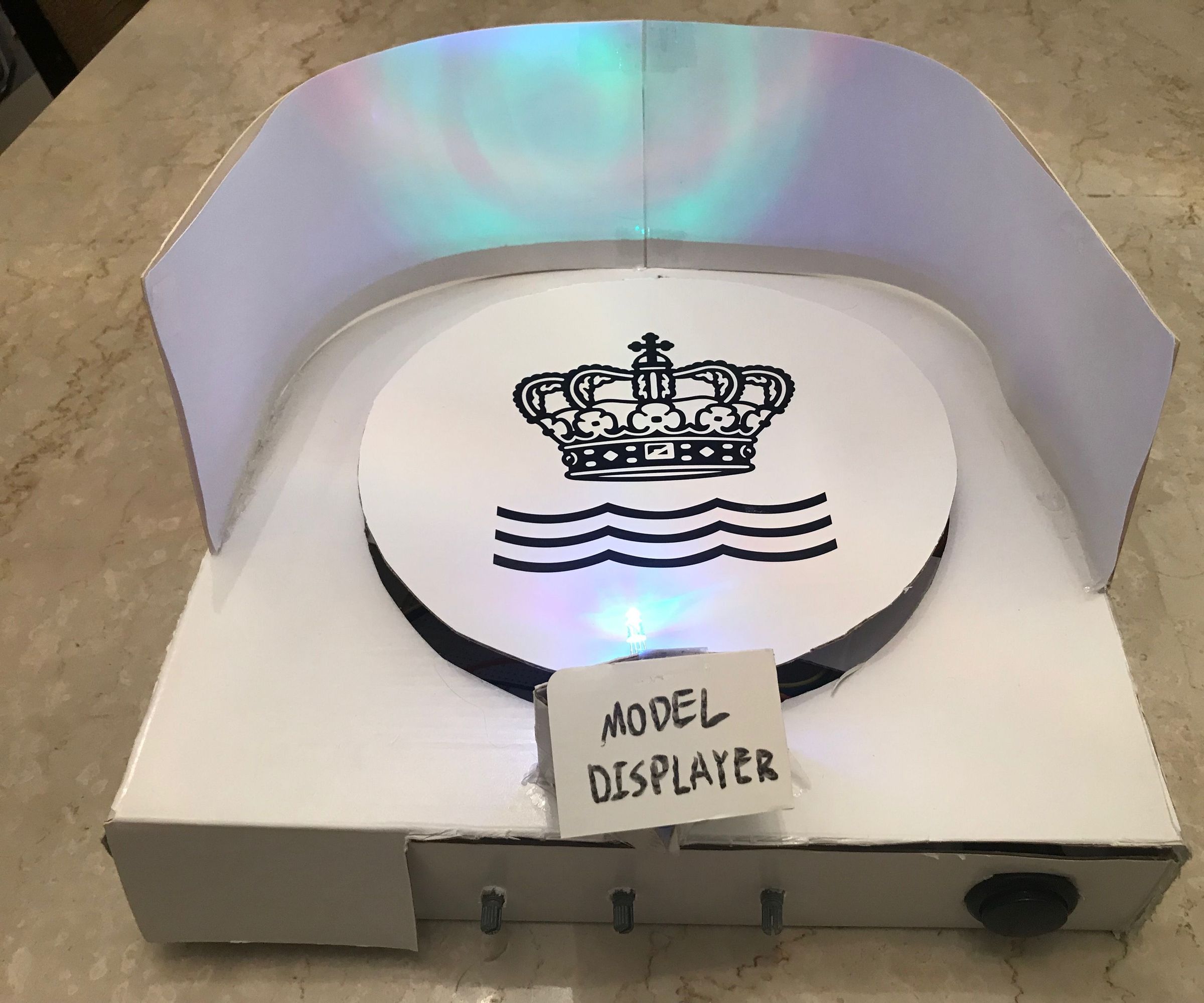

This displayer combines motor, RGB light bulb, and adjustable resistors to create a displayer with light-controllable technique. The user could adjust the displaying light to fit the style of the model (act like a filter). The spinning stage is a little faster than usual, but you are able to control the speed with a button. As you can see the two photos of Luffy model, you could change its color based on the style of the model. In this case, the red light might be more suitable than the green light. The wiring process is quite complex, so you must follow the instructions. Have fun !!!

Step 4: Structure-Building
This part is the most complex stage, but the structure of the displayer is partially custom-made. During this stage, using scissors or box cutter to cut cardboard into components of the structure and using hot glue to them together are extremely recommended. There are a few parts that are critical for its function or appearance:
  • The RGB LED should be placed in front of the displayer.
  • The button should be inserted anywhere that is convenient to be pressed on.
  • The three resistors should be placed outside and allow the user to rotate them without any trouble.
  • The plate that is attached to the motor to hold the model should be fixed on the motor in case of losing balance.
  • The two USB electrical interface should be connected to the external source (ex. portable charger)
