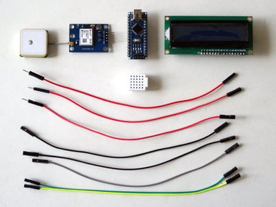

Step 1: Components
- One Arduino compatible board (I use Arduino Nano, because I have one, but any other will be just fine)
- One GPS module
- One I2C 16x2 LCD Display (Back side of the LCD with the I2C adapter showed on Picture 2)
- One small Breadboard (Any breadboard can be used, or any other way to connect 3 wires together)
- 3 Female-Male jumper wires
- 5 Female-Female jumper wires

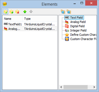

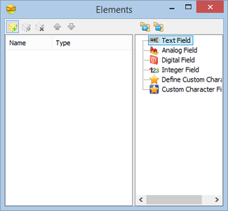

- Click on the "Tools" button (Picture 1) to open the "Elements" editor (Picture 2)

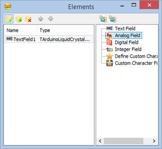

- In the "Elements" editor select the "Text Field" in the right window, and click on the "+" button on the left (Picture 2)
- In the Object Inspector set the value of the "Initial Value" property of the element to "Lat. :" (Picture 3)
- Select the "Analog Field" in the right window of the "Elements" editor, and clicking on the "+" button on the left (Picture 4)
- In the Object Inspector set the value of the "Column" property of the element to "7" (Picture 5)
- In the Object Inspector set the value of the "Width" property of the element to "8" (Picture 6)

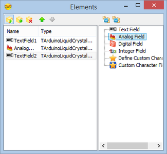

- In the "Elements" editor select the "Text Field" in the right window, and click on the "+" button on the left (Picture 1)
- In the Object Inspector set the value of the "Initial Value" property of the element to "Long.: " (Picture 2)

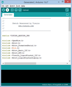

- In Visuino, Press F9 or click on the button shown on Picture 1 to generate the Arduino code, and open the Arduino IDE
- In the Arduino IDE, click on the Upload button, to compile and upload the code (Picture 2)

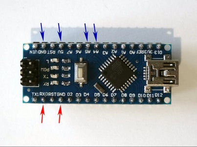

- Picture 3 shows where are the Ground, 5V Power, SDA/Analog pin 4, and SCL/Analog pin 5 pins of the Arduino Nano

- Picture 3 shows in Red where are the Ground, and RX pins of the Arduino Nano (In Blue are shown the connections made in the previous step)

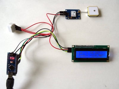

Step 12: And Play...
Congratulations! You have completed the project.
Picture 1 shows the connected and powered up project. If you power up the project, after a while the blue LED of the GPS will start blinking about once a second as you can see on the Video. Usually shortly after that, the GPS will start sending location data, and it will be shown on the LCD. Depending on the location, it can take up to few minutes to show the location data. If after few minutes the data is still not shown, power down the project wait about a minute and power it again to reset the GPS.

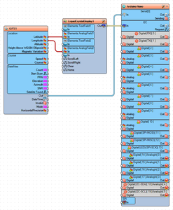

On Picture 2 you can see the complete Visuino diagram.
