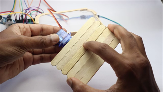

I will expand the servo shaft horn using a long piece of popsicle stick, now i will take 8 piece of popsicle stick and glue them together so that it will take up the shape of rectangle.
You can trim the excess part later depending on the container size but considering my box size this will serve well, connect this square to the servo shaft using mix of hot and super glue, i first used super glue and for additional strength i will use hot glue and allow to dry completely before proceeding to next step.

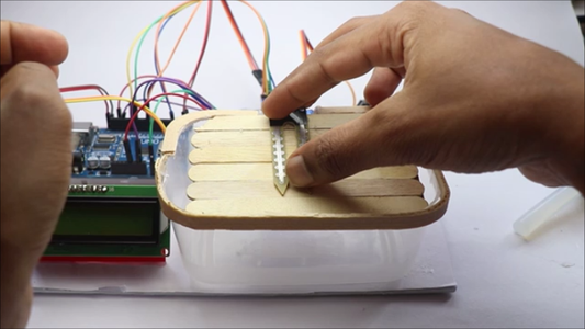

Place servo to the side of the box and seal it with hot glue, now adjust the space between them so that the mechanism opens and close flawlessly.
Upon this we will be placing soil moisture sensor and i will use drops of hot glue for this purpose, to the side i will place a small slice of cardboard and to the top of which i will add ultrasonic sensor that will detect the obstacle.

Now place any object above the moisture sensor, if it has moisture/water content and if it is detected by this sensor then the servo will move to the left thereby dropping the object to the left.
On the other hand if the object detected by moisture sensor has no water content and is in front of ultrasonic sensor than the servo moves to the right anf it falls under dry category.
