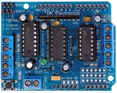

  • Adafruit Motor/Stepper/Servo Shield for Arduino kit - v1.2 Learn More about
    (You can also use other clone Shields that you can buy online) Get it here

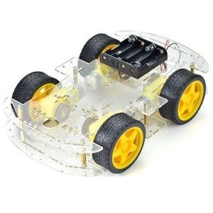

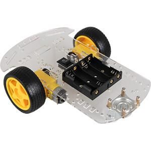

  • 2WD or 4WD RC car Chassis Kit

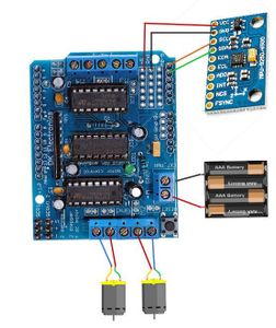

  • Attach Motor Shield to the Arduino board
  • Connect MPU9250 Sensor pin [SCL] to Motor Shield pin [A5]
  • Connect MPU9250 Sensor pin [SDA] to Motor Shield pin [A4]
  • Connect MPU9250 Sensor pin [VCC] to Motor Shield pin [5v]
  • Connect MPU9250 Sensor pin [GND] to Motor Shield pin [GND]
  • Connect DC motor1 wires to the Motor Shield Blue pins [M1]
  • Connect DC motor2 wires to the Motor Shield Blue pins [M2]
  • Connect Battery red wire (+) to the Motor Shield Blue pin [M+]
  • Connect Battery black wire (-) to the Motor Shield Blue pin [GND]
  • When you Power the Motor Shield a green LED should be On

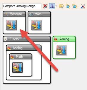

  • Add "Accelerometer Gyroscope Compass MPU9250 I2C" component
  • Add "Compass Heading" component

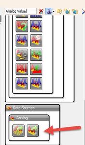

  • Add "Compare Analog Range" component
  • Add "Analog Value" component
  • Add "Digital (Boolean) Inverter (Not)" component

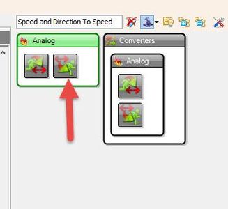

  • Add 2X "Speed and Direction To Speed" component

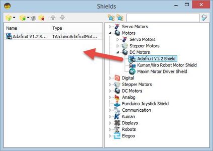

  • Right mouse Click on the Arduino board and in the popup menu select "Add Shields" (see Picture1)
  • In the "Shields" window select "Adafruit V1.2 Shield" and drag it to the left side (see Picture2)
  • Close the "Shields" window

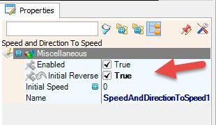

  • Select "SpeedAndDirectionToSpeed1" and in the Properties window set "Initial Reverse" to True
This will reverse the Start Direction, Depending on your motor wiring, you can leave this to False
  • Select "SpeedAndDirectionToSpeed2" and in the Properties window set "Initial Reverse" to True"

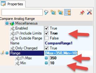

  • Select "CompareRange1" and in the Properties window set
  1. "Range" > "Max" to 350
  2. "Range" > "Min" to 10
  3. "Include Limits" to True

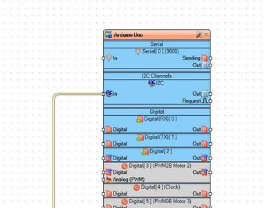

  • Connect "AccelerometerGyroscopeCompass1" Compass Pin [X] and Pin [Y] to "CompassHeading1" Pin [X] and Pin [Y]
  • Connect "AccelerometerGyroscopeCompass1" Pin I2C [Out] to Arduino board pin I2C [In]
  • Connect "CompassHeading1" Pin [Out] to "CompareRange1" pin [In]
  • Connect "AnalogValue1" pin [Out] to "SpeedAndDirectionToSpeed1" pin [Speed]
  • Connect "AnalogValue1" pin [Out] to "SpeedAndDirectionToSpeed2" pin [Speed]
  • Connect "CompareRange1" pin [Out] to "Inverter1" pin [In]
  • Connect "Inverter1" pin [Out] to "SpeedAndDirectionToSpeed2" pin [Reverse]
  • Connect "SpeedAndDirectionToSpeed1" pin [Out] to "Arduino" > "Driver1" pin [Motor1]
  • Connect "SpeedAndDirectionToSpeed2" pin [Out] to "Arduino"> "Driver2" pin [Motor1]

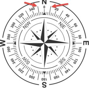

Since the optimal degree would be 0 (See Picture1) we will say if Degrees are Less than 10 or more than 350 we will consider this as being North, everything Else will Trigger The Motor to Reverse.
  • "CompareRange1" will determine If it is from 10-350 (Consider not being North) It will trigger the Inverter and then "SpeedAndDirectionToSpeed2" pin [Reverse]
Note: You could lower the range but since the motors are spining quite fast the Compass Sensor might not register the position so fast, this is something to be experimented with.
You can also change the range for other direction if you want, for South you could set "CompareRange1" Max to 190 and Min to 170
