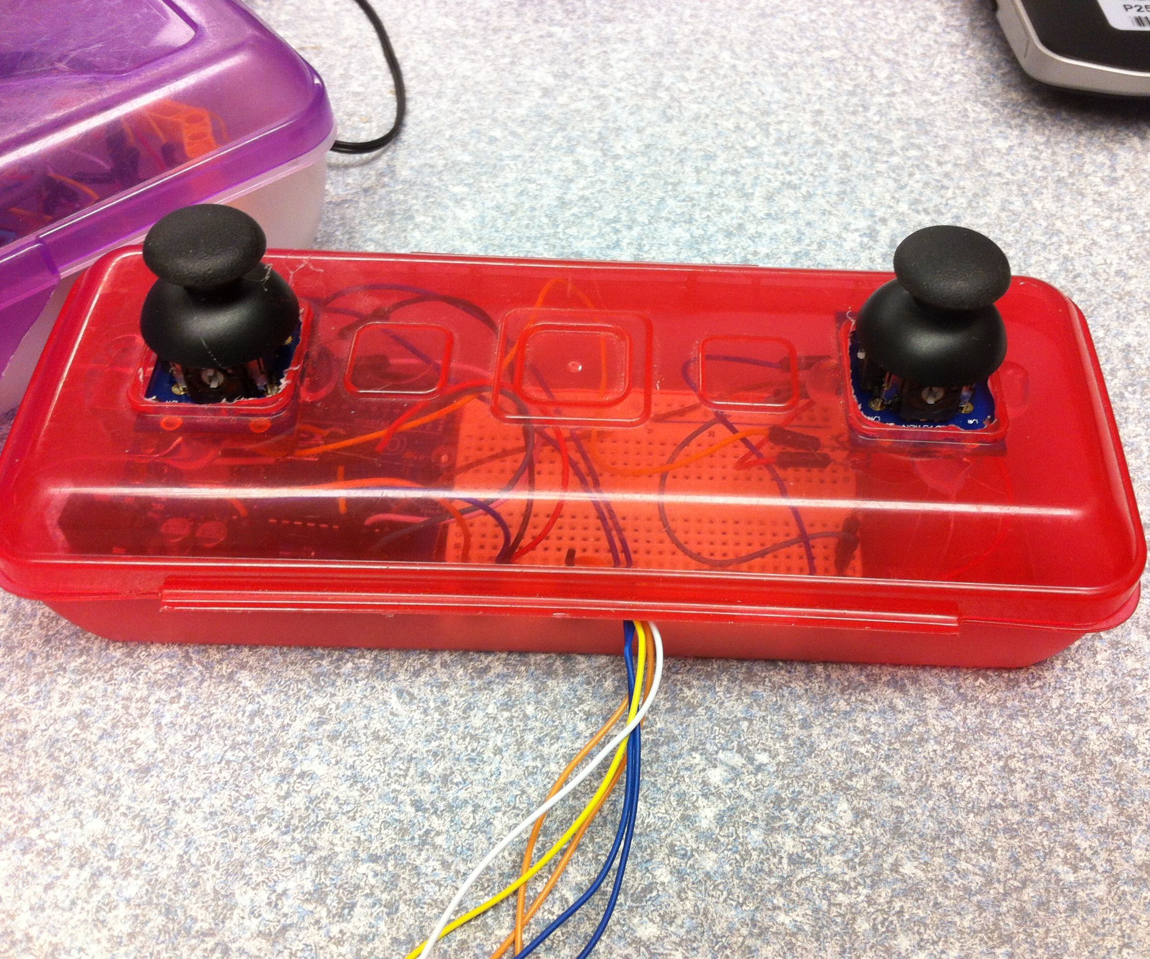

Step 7: Joystick Connections (Joy_1) LEFT
Here is the connections for Joy_1 or the LEFT joystick. The Parallax joystick has 2 grounds and they need to be connected. For all this connections you need 2 bread boards for each joystick. (or a big one) But I feel less confusing when I use for each joystick a small bread board. Pay attention to all the connections and double check them.
L/R+ and U/R+ is the 5V Arduino connection (power)
GND and GND is for ground on the arduino
L/R and L/R goes to the Arduino ANALOG connection A2
U/D and U/D goes to the Arduino ANALOG connection A5
Step 8: Joystick Connections (Joy_2)
Here is the connections for Joy_2 or the RGHT joystick. The Parallax joystick has 2 grounds and they need to be connected. For all this connections you need 2 bread boards for each joystick. (or a big one) But I feel less confusing when I use for each joystick a small bread board. Pay attention to all the connections and double check them.
L/R and L/R goes to the Arduino ANALOG connection A4
U/D and U/D goes to the Arduino ANALOG connection A3

Step 13: Troubleshooting
1. The servos won't move.
A. Check the connections, remember in this tutorial we use PWM pins for the servos and the Analog pins for the joysticks.
2. When I upload the code to the board the servos, they start vibrating.
A. It means that either U/D+ or L/R+ are not properly connected. Double check your connections. You have to disconnect the usb from the board to verify connections try to review the connections on the steps 5 -8.
3. I double check the connections and the servos wont move.
A. Take out the joystick and reconnect it again in the bread board by pressing it down to make sure it is connected. Connections have to be tight from the joystick to the bread board.
4. There is a vibration from one of the servos.
This happens because of the combination of micro servos and standard servos. (I did this project with 4 Parallax standard servos with no vibration issues at all). The micro servos used in here are the cheap ones from Ebay. They are good for testing purposes though.
Any other help or issues you have feel free to let me know and I will be glad to help all of you. ;)
