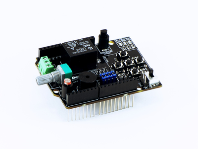

Introduction: Arduino Starter Shield
The Educational Shield of Innoesys combines many peripheral components on its PCB. There are solder and ready to use by the novice user, who is not necessary to have knowledge in electronics theory. So no connections with cables, resistors and breadboards are needed.
Educational Shield Features:
  • LED (R+G+B): Three LEDs in different colors connected at the digital outputs D6 (Red), D9 (Green) and D10 (Blue).
  • Buttons: Five buttons connected at the digital inputs D7 (S1), D8 (S2), D11 (S3), D12 (S4) και D13 (S5)
  • On-Off Switch: A two position switch (On-Off) connected at the digital input D4
  • Relay: A relay connected at the digital output D2
  • Potentiometer: A potentiometer connected at the analog input A1
  • Βuzzer: A buzzer for sound notification connected at the digital output D5
  • Photoresistor: A photoresistor in analog input A2
  • Temperature Sensor: A temperature sensor connected at the analog input A0
  • Servo Motor Connector: A three pin connector for connecting servo motor. The pin is connected at the digital output D3
Details and further information about the educational shield can be found in the manufacturer datasheet (www.innoesys.com)
Buy Educational Shield Online or on Ebay

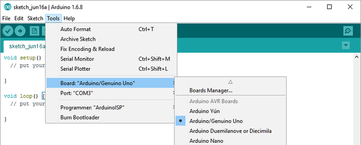

Step 4: Arduino IDE
Finally we start the Arduino IDE environment, which we have previously installed in our PC. In the window that opens we see to sections. In the first section void setup() we place the configuration. This section of code will “run” only once when the Arduino board powers on, In the second section void loop() we place the code lines that will be run repeatedly.
