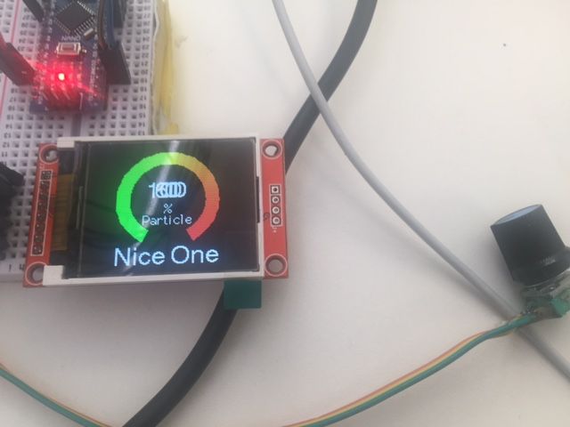

I am quite a fan of the Arduino as there is so much software already available on the internet, this makes completing new projects easier!
Recently I bought a few cheap 1.8" TFT displays for a project, initially I could not get them working which was frustrating. Eventually I found that the ones I had bought used the Samsung S6D02A1 driver chip and I had been trying to use the wrong library.
After a brief search on the web I came across the Adafruit_QDTech library which worked really well. This library is used in conjunction with the Adafruit_GFX library. After trying some examples I was a little disappointed that only scaled blocky fonts were available - so I have modified the original libraries to add some new fonts and functions.

Step 1: Wiring It Up
I used the Arduino UNO and linked it to the 1.8" S6D02A1 based display as follows:
  • UNO +5V to display pin 6 (VCC) and pin 7 (BL)
  • UNO 0V (GND) to display pin 8 (GND)
  • UNO digital pin 7 through a 1K2 resistor to display pin 1 (RST)
  • UNO digital pin 8 through a 1K2 resistor to display pin 3 (D/C)
  • UNO digital pin 9 through a 1K2 resistor to display pin 2 (CS)
  • UNO digital pin 11 through a 1K2 resistor to display pin 4 (DIN)
  • UNO digital pin 13 through a 1K2 resistor to display pin 5 (CLK)
The 1K2 resistors are required to protect the display being damaged by the 5V logic levels from the UNO, these limit the current flow. Ideally we could use a level shifter but the resistors work fine.

    majdi131590
    majdi131590
    3 years ago
    Hi Bodmer,
    thank you very much for this work, please check attached pictures, it working fine using tft7735 1.8" and everything alright except, when i use code to read from my sensor: reading= analogRead(A0).
    as you can see from the picture first reading is ok but when i change the potentio-meter numbers not clear as the previous numbers seems not updated, i guess its string char conversion but i stuck and i need help if that ok to clear this.
    Thank you very much
    0
    Bodmer
    Bodmer
    Reply 3 years ago
    Set the foreground and background colors and the test should overwrite old values.
    0
    Bodmer
    Bodmer
    Reply 3 years ago
    It looks like you have switched off rendering the font text background?
    Use a line like:
    tft.setTextColor(TFT_WHITE,TFT_BLACK);
