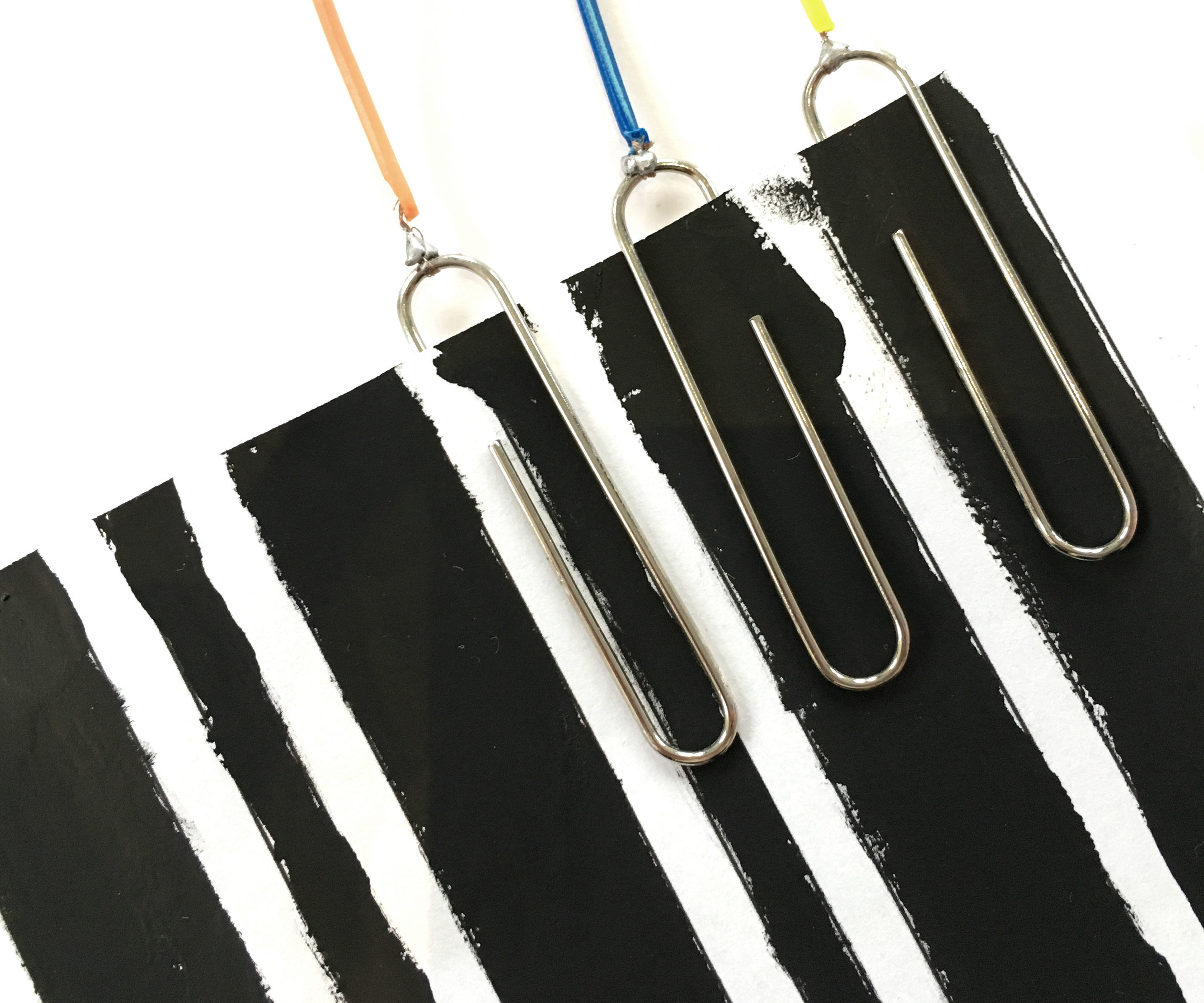

build the circuit as in the pictures.
The end of the wires is where you would touch it. You can attach alligator clips to the ends of the wire so you can clip the wires to alliminium foil for example.
