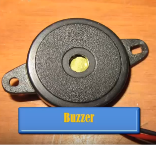

Step 1: You Will Need:
- LED
- Laser
- Photoresistor
- Piezo Buzzer
- Breadboards
- Arduino uno
- Resistor 10Ω Resistor
- 220Ω Resistor for led.
- jumper wire

Question 1 year ago on Step 1
Hi,
may I ask you which piezo buzzer you used and which light sensor and which laser?
Maybe you have links (ebay / amazon etc.) for me?
I would love to build this project - but I am a little overwhelmed because there are so many different buzzers etc. and I don‘t which one is right....
You would really help me a lot :-)
This will be my first Arduino project by the way :-)
Best regards
Aurel
