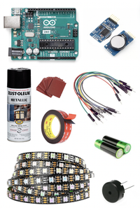

Parts used:
  • Arduino Uno and Breadboard
  • Batteries
  • RTC DS3231 Module
  • Jumper wires
  • WS2812B LED Strip
  • Double Sided Tape
  • 3D Printed Lamp Design
  • Glue
  • Piezo Speaker
  • Ultrasound Sensor (not used as planned)
Step 1: Parts
Gather every part that is required in order to create a circuit. Parts used can be find in the supplies section.
