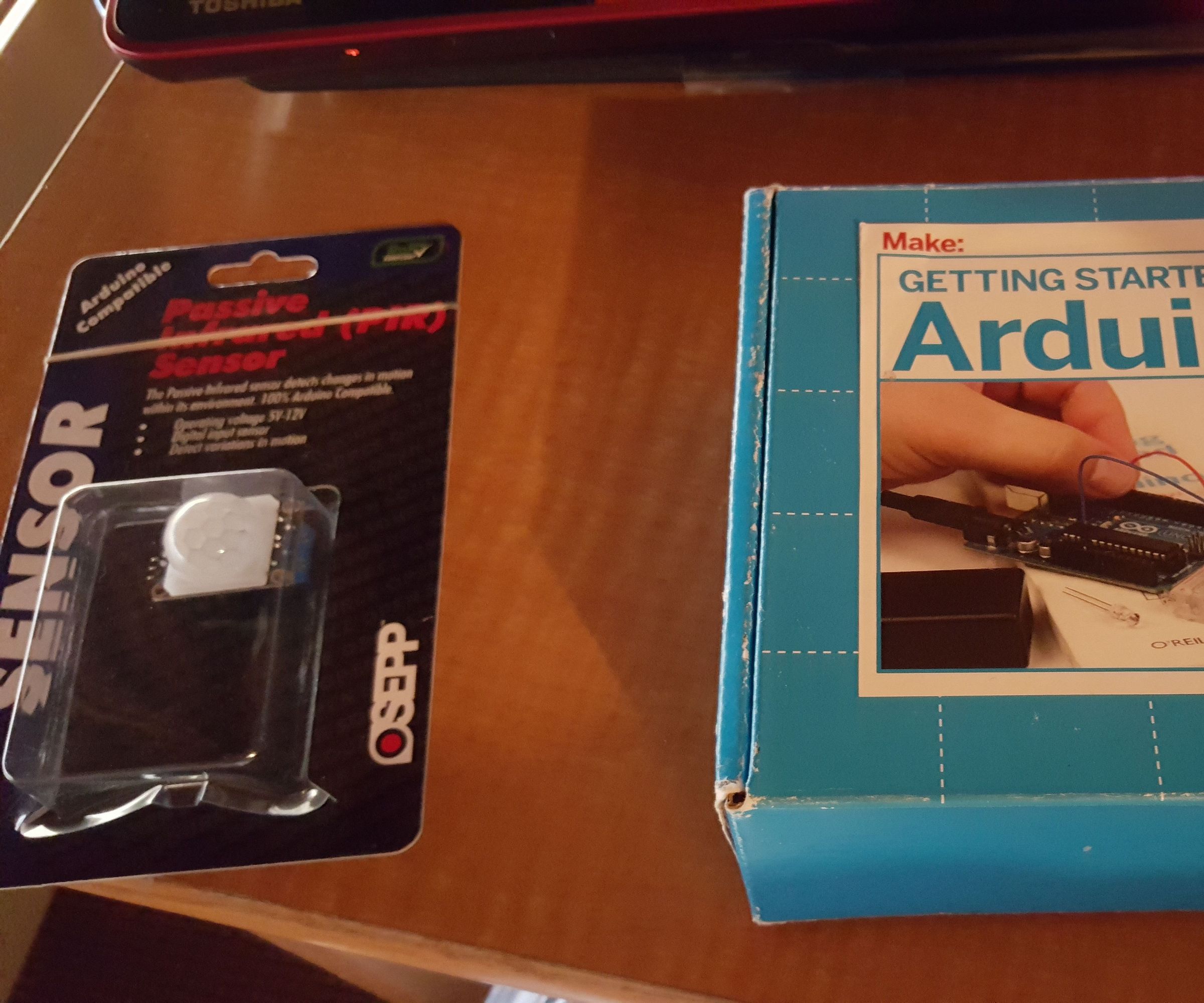

First off, you will have to gather the materials needed for the project.
* Arduino - I used an UNO, but I am sure most models will work fine. This simple project only needs power and an Analog Input, so make sure your board has those options
* Sensor - OSEPP Flame Sensor:
http://osepp.com/products/sensors-arduino-compatib...
* (5) Jumper Wires - You can use stripped Cat5 or any other wire you want. I am using some jumper wires I had lying around
* Breadboard - I am using one that I bought at my local RadioShack before they closed shop. It is larger than needed, but it gets the job done!
* Arduino IDE
