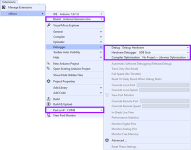

First ensure you have the project loaded you want to debug
Set the correct Board and COM port
Change the Debugger > Debug option to "Hardware"
Change the Debugger > Hardware debugger option to "GDB Stub"
Finally change the Optimisation setting to the recommended "No Project + Libraries Optimization"

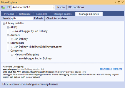

To Install the GDBStub Code
  • vMicro > Add Library > Download and Install Arduino Library > Manage Libraries Tab
  • Enter "gdb" as the Search term
  • For the Uno we can use the "avr-debugger by Jan Dolinay"
  • Left click to install the library (see more about libraries here)
  • Click the Rescan button at the top when the install has completed
  • Now close the Visual Micro Explorer

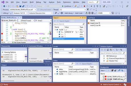

Add a break point to your sketch by clicking in the left hand margin.
You can add more than one, and up to 4
Step 5: Debugging
To start the debugging process, you can either:
  • "Debug > Attach to Process" button if your code has already been uploaded to the board
  • "Debug > Start Debugging" if your code has not been uploaded
Now you can debug in Visual Micro as normal on your Arduino Uno, without an external hardware debugger.
