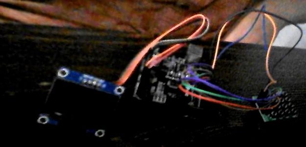

Step 1: Creating the Circuit
Keypad Wiring:
  1. Connect keypad rows to pins 2, 3, 4, 5 (Arduino)
  2. Connect keypad columns to pins 6, 7, 8, 9 (Arduino)
OLED Display Wiring (I2C):
  1. GND → GND
  2. VCC → 5V
  3. SCL → A5
  4. SDA → A4
