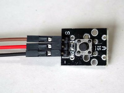

Step 4: Connect the Button and the LED Modules to the PCF8574/PCF8574A GPIO Module
  1. Connect Female-Female Button Signal (Brown wire) to the "Signal"Pin of the Button Module
  2. Connect Female-MalePower (Red wire) to the "+" pin of the Button Module
  3. Connect Female-MaleGround (Black wire) to the "-" pin of the Button Module

  8. Connect the other end of the Button Signal (Brown wire) to the P0 pin of the PCF8574/PCF8574A GPIO Module

Connect the Male ends of the 3 Power wires(Red wires) - from the Button Module, the PCF8574/PCF8574A GPIOModule, and the Arduino together as example with the help of a Breadboard (Picture 1) - In my case I used asmall Breadboard
